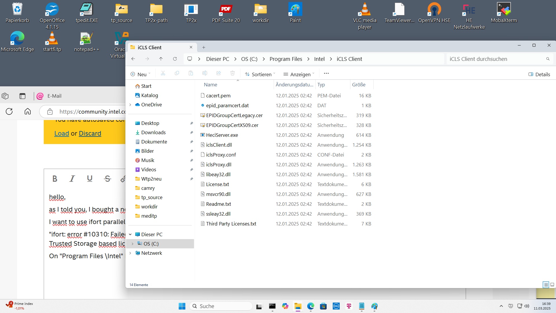

hello,
as I told you, I bought a new PC. I have I save from my old disk and copied the ifort compiler to "Program Files (X86) \Intel".
I want to use ifort parallel to ifx. If I exequte ifort, I got this Message:
"ifort: error #10310: Failed to enable trusted storage check for licensing: WARNING: Enable Trusted Storage failed (flexnet error code 20).
Trusted Storage based license could not be supported"
On "Program Files \Intel" I have my licence dir with files below:
Can you help me?
