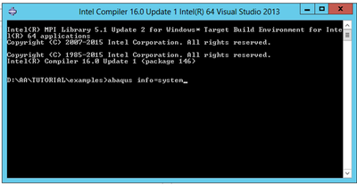

This is the command prompt I'm using to verify the installation and linking of intel with vs and abaqus

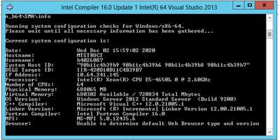

then I run this command to verify that it is correctly linked and I'm getting the error.
Not sure why, as it was working before, only started getting problems when the license expired

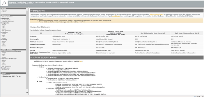

The attached guide says:
This brief manual describes how to get FORTRAN linking and user subroutines working in Abaqus2017. These instructions have been tested with the following software combination (Microsoft community Visual Studio 2013 + ABAQUS 2017 + Intel Parallel Studio XE 2016 update 4). These instructions may work with other versions but you will need check that Intel Parallel Studio can be integrated to MS Visual Studio and that Intel Parallel Studio does not override MS MPI version coming with Abaqus installation.
That's why newer versions of intel might not be working ?

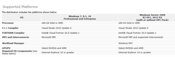

This is a compatibility table shared by Abaqus
Steve_Lionel
4,323 Views
That generally means that Abaqus hasn't bothered to test with newer versions. There's no fundamental reason a newer compiler shouldn't work. At most. any Abaqus-supplied scripts might need to be pointed at the installed compiler.
arlene
4,307 Views
I think newer compilers might work and be compatible with newer Abaqus versions (like 2020), however I have Abaqus 2017, which is not compatible with the newer Intel versions.

in the post of 02-12-2020 04:03 PM you seem to be in the compiler 16 command prompt but you also seem to be saying that is not installed/working/licenced? If you are trying to use a  later compiler then the command prompt environment for that later compiler will be needed as it will set the correct environment.
It may also be that some ABAQUS scripts  need to be modified to point at the correct (later compiler).
