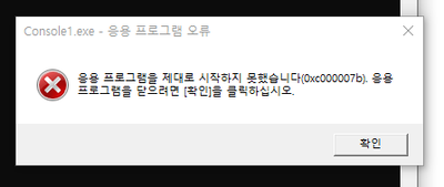

Hello, Steve. I'm Park, a graduate student living in korea. I was using parallel studio XE, but my license expired, so i started oneAPI for the first time. So i deleted all the fortran compilers and proceeded to reinstall them, but i encountered the problem of "the entry point for_stop_core_quiet is not located". I could build the program without any error but i got the error when i executed the .exe program.
I confirmed that libifcoremd.dll exists in my lib path 'C : \ Program Files (x86) \ Intel \ oneAPI \ compiler \ 2021.1.1 \ windows \ lib \ x64' and the version is 11.1.5.5. & 20.0.1.0 (tried both version).
And i installed the runtime version of Intel Fortran Compiler Classic for windows. (How do i add it to the system path environment variable?). After this process, i got the following error. (The application program failed to start properly (0xc000007b).)
Thank for your help.
Park.
See if installing the Visual Studio runtime from The latest supported Visual C++ downloads (microsoft.com) helps. The Intel runtime installer added the correct folders to Path - you don't have to do this yourself.
I was advised that an error occurred because of conflict with previous version, so i deleted all compilers and reinstalled oneAPI *& visual studio (2017, 2019). I got an error that libifcoremd.dll is missing, so i downloaded all of C++ and Fortran compiler classic.
After that, i get the following error that application program failed to start (0xc000007b), but i don't know how to deal with it.

Did you install the Microsoft Visual Studio runtime as I suggested above? The error you are seeing is caused by inconsistent DLLs. The advice I usually see suggests installing the latest Visual Studio runtime.
I have installed above 3 files. I got the same error after installing the 1st and 2nd files.
And when installing the 3rd file, the following error occurs. (The installation package is not supported on the current platform)

Good thing the third package would not install for you! It's not for your architecture.
Let's try a couple of things. First, in your Fortran project properties, go to Fortran > Libraries. Change "Runtime library" to "Multithreaded" (not Multithread DLL"). Rebuild. Do you get an error when linking, and if not, does the program run?
If it does, reset that property back to Multithread DLL. Now go to property page Linker > General. Change "Show Progress" to "Show all progress Messages". Rebuild. Zip the buildlog.htm from the Debug or Release folder (depending on your configuration) and attach the .zip to a reply here.
Through the first method, No error occurs when rebuild.
But the .exe file does not run. (It does not run without any error)
Next, i reset that property back and i attach the zip file that you mentioned.

The log in the zip you attached does not show an error. What do you mean by "the .exe file does not run" when you changed the library property?
<Change the fortran library>
-> change the fortran library property.
When i executed the exe file, nothing happened under both x64, x86 release. (No error occurred.)
<No change the fortran library property>
Even with the x64 release (exe file) nothing happened.
However, the 0xc000007b error occurs only in x86 release.
