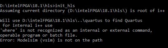

Hi, I am so new to Intel FPGA products and softwares, I have installed Quartus Prime 18.1 Standard Edition / Model Sim - Intel FPGA Starter Edition 10.5b and Microsoft Visual Studio 2010 Professional as it is said in Intel High Level Synthesis Compiler Getting Started Guide. My quartus prime installation directory is "D:" since there is not enough disk space on "C:". Then I follow the steps to initialize Intel HLS Compiler Environment.

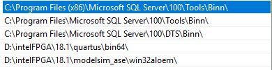

I have set user variables environment path and system variables environment path as given in picture then closed and reopened Visual Studio 2010 command prompt and tried again but I still got the same error given in picture. hls.JPGuser variable path.JPGsystem variables path.JPG

The Error: Modelsim (vsim) is not on the path is related to environment variable. Which is used to check that we have Modelsim in our path.
I have below setting which is working fine.
PATH=C:\intelFPGA\18.1\modelsim_ase\win32aloem
VisualStudio=C:\Program Files (x86)\Microsoft Visual Studio 10.0\VC\bin
QUARTUS_ROOTDIR=C:\intelFPGA\18.1\quartus
Kindly retry by restarting the system also check if you have vsim.exe under C:\intelFPGA\18.1\modelsim_ase\win32aloem

I have exactly same sttings with you except my quartus prime paths are under "D:", does it change anything?
There also exists vsim.exe under win32aloem.
