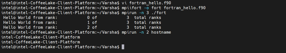

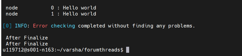

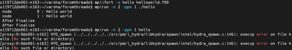

After initializing the Intel oneAPI environment, all the libraries will be set in LD_LIBRARY_PATH. You can export the libraries only if you didn't find them after initializing the oneAPI.
I am able to build the OpenMPI with the Intel compilers without getting any errors. Please find the below screenshot of it during "make":
And also, we want to let you know that Intel oneAPI has its own MPI where you can able to use it just by initializing the oneAPI environment. You just need to install the Intel HPC Toolkit and do initialize the oneAPI environment to use the Intel MPI Library.
To download Intel HPC Toolkit please find the below link:
https://www.intel.com/content/www/us/en/developer/tools/oneapi/hpc-toolkit-download.html
To set up the oneAPI environment, use the below command:
source /opt/intel/oneapi/mpi/2021.5.0/env/vars.sh
To compile & run a sample MPI program:
https://www.intel.com/content/www/us/en/develop/documentation/mpi-developer-guide-linux/top/compiling-and-linking/compiling-an-mpi-program.html
Also, could you please let us know the specific reason for using the OpenMPI rather than Intel MPI so that your feedback helps us to understand better about your issue?
Thanks & Regards,
Varsha

Could you please try compiling and running the sample Fortran MPI Helloworld by using the below commands?
For Compiling, use the below command:
mpiifort -o hello hello.f90
For Running the MPI program, use the below command:
mpirun -n 2 ./hello
Could you please check if you are able to get the results for "hostname" by using the below command? Please find the below screenshot for more information.
mpirun -n 2 hostname
If you are facing errors while running the above cases, then could you please try reinstalling and running the above cases again?
Please do let us know if you are facing the issues even after reinstalling the toolkits.

Thanks for providing the detailed information.
From the steps given by you((On the workstation where original problem exists, On login node), we have observed that while running the MPI code you were using the command "mpirun -n 2 hello" instead of "mpirun -n 2 ./hello".
We can face a similar issue if the binary file path is wrong. Please refer to the below image in which we were able to reproduce the same issue.
Please find the below link for more information:
https://www.intel.com/content/www/us/en/develop/documentation/mpi-developer-guide-linux/top/troubleshooting/error-message-no-such-file-or-directory.html
We suggest you try running the below command and let us know if it works:
mpirun -n 2 -ppn 1 ./hello
On the interactive queues, could you please try the below command for checking the correctness of the MPI code?
mpirun -check_mpi -n 2 -ppn 1 ./hello
If there is no issue with the MPI code, then it will appear as present in the below screenshot :
Could you please provide us with the results using the below command for the normal queue:
mpirun -check_mpi -n 2 -ppn 1 I_MPI_DEBUG = 30 FI_LOG_LEVEL=debug ./hello

The following run with
mpirun -check_mpi -n 2 -ppn 1 ./hello_mpi
produces the following on error channel
Loading compiler version 2021.1.1
Loading tbb version 2021.1.1
Loading debugger version 10.0.0
Loading compiler-rt version 2021.1.1
Loading dpl version 2021.1.1
Loading oclfpga version 2021.1.1
Loading init_opencl version 2021.1.1
Warning: Intel PAC device is not found.
Please install the Intel PAC card to execute your program on an FPGA device.
Loading compiler/2021.1.1
Loading requirement: tbb/latest debugger/latest compiler-rt/latest dpl/latest
/opt/intel/oneapi/compiler/2021.1.1/linux/lib/oclfpga/modulefiles/init_opencl /opt/intel/oneapi/compiler/2021.1.1/linux/lib/oclfpga/modul\
efiles/oclfpga
Loading mpi version 2021.1.1
Currently Loaded Modulefiles:
1) tbb/latest
2) debugger/latest
3) compiler-rt/latest
4) dpl/latest
5) /opt/intel/oneapi/compiler/2021.1.1/linux/lib/oclfpga/modulefiles/init_opencl
6) /opt/intel/oneapi/compiler/2021.1.1/linux/lib/oclfpga/modulefiles/oclfpga
7) compiler/2021.1.1
mpi/2021.1.1
[LOG_CAT_SBGP] libnuma.so: cannot open shared object file: No such file or directory
[LOG_CAT_SBGP] Failed to dlopen libnuma.so. Fallback to GROUP_BY_SOCKET manual.
[0] INFO: CHECK LOCAL:EXIT:SIGNAL ON
[0] INFO: CHECK LOCAL:EXIT:BEFORE_MPI_FINALIZE ON
[0] INFO: CHECK LOCAL:MPI:CALL_FAILED ON
[0] INFO: CHECK LOCAL:MEMORY:OVERLAP ON
[0] INFO: CHECK LOCAL:MEMORY:ILLEGAL_MODIFICATION ON
[0] INFO: CHECK LOCAL:MEMORY:INACCESSIBLE ON
[0] INFO: CHECK LOCAL:MEMORY:ILLEGAL_ACCESS OFF
[0] INFO: CHECK LOCAL:MEMORY:INITIALIZATION OFF
[0] INFO: CHECK LOCAL:REQUEST:ILLEGAL_CALL ON
[0] INFO: CHECK LOCAL:REQUEST:NOT_FREED ON
[0] INFO: CHECK LOCAL:REQUEST:PREMATURE_FREE ON
[0] INFO: CHECK LOCAL:DATATYPE:NOT_FREED ON
[0] INFO: CHECK LOCAL:BUFFER:INSUFFICIENT_BUFFER ON
[0] INFO: CHECK GLOBAL:DEADLOCK:HARD ON
[0] INFO: CHECK GLOBAL:DEADLOCK:POTENTIAL ON
[0] INFO: CHECK GLOBAL:DEADLOCK:NO_PROGRESS ON
[0] INFO: CHECK GLOBAL:MSG:DATATYPE:MISMATCH ON
[0] INFO: CHECK GLOBAL:MSG:DATA_TRANSMISSION_CORRUPTED ON
[0] INFO: CHECK GLOBAL:MSG:PENDING ON
[0] INFO: CHECK GLOBAL:COLLECTIVE:DATATYPE:MISMATCH ON
[0] INFO: CHECK GLOBAL:COLLECTIVE:DATA_TRANSMISSION_CORRUPTED ON
[0] INFO: CHECK GLOBAL:COLLECTIVE:OPERATION_MISMATCH ON
[0] INFO: CHECK GLOBAL:COLLECTIVE:SIZE_MISMATCH ON
[0] INFO: CHECK GLOBAL:COLLECTIVE:REDUCTION_OPERATION_MISMATCH ON
[0] INFO: CHECK GLOBAL:COLLECTIVE:ROOT_MISMATCH ON
[0] INFO: CHECK GLOBAL:COLLECTIVE:INVALID_PARAMETER ON
[0] INFO: CHECK GLOBAL:COLLECTIVE:COMM_FREE_MISMATCH ON
[0] INFO: maximum number of errors before aborting: CHECK-MAX-ERRORS 1
[0] INFO: maximum number of reports before aborting: CHECK-MAX-REPORTS 0 (= unlimited)
[0] INFO: maximum number of times each error is reported: CHECK-SUPPRESSION-LIMIT 10
[0] INFO: timeout for deadlock detection: DEADLOCK-TIMEOUT 60s
[0] INFO: timeout for deadlock warning: DEADLOCK-WARNING 300s
[0] INFO: maximum number of reported pending messages: CHECK-MAX-PENDING 20
[0] INFO: Error checking completed without finding any problems.
And it produces the following relevant output.
