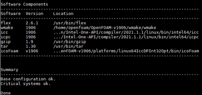

Xiaoqiang
7,154 Views
Hi Prasanth,
You can reproduce the problem by performing the following steps:
  • Downloading Openfoam and Third-Party Library Source Codes
https://altushost-swe.dl.sourceforge.net/project/openfoam/v1906/OpenFOAM-v1906.tgz
https://altushost-swe.dl.sourceforge.net/project/openfoam/v1906/ThirdParty-v1906.tgz
  • Decompress the source code package to the same directory
  • Configuring the Environment Variables of the Intel OneAPI
  • Configuring OpenFOAM Environment Variables
cd OpenFOAM-v1906
vim etc/bashrc
Modify the configuration file to use the Intel OneAPI.
After the modification, load environment variables.
source etc/bashrc
When you load environment variables for the first time, a message is displayed indicating that the software is not installed. Rest assured, don't worry about this tip.
  • Compile the program using the built-in script.
./Allwmake -j 8 -s -k -q
It takes a long time to compile, which may take up to 2 hours.
After the compilation is complete, load environment variables again.
Check whether the OpenFOAM is successfully installed.
(scotch6.0.6 is compiled through mpiicc with O3 option)
  • Run test cases to reproduce the problem
cd tutorials/incompressible/pisoFoam/LES/motorBike/motorBike/
./Allclean
./Allrun
You can see the error information in the log.snappyHexMesh file.
  • Recompile scotch_6.0.6
cd ThirdParty-v1906/scotch_6.0.6/src
Modify the Makefile.inc file and use mpicc.
Compiling Library Files, and add the newly generated library to the environment variable.
make clean && make libptscotch -j
cd libscotch
export LD_LIBRARY_PATH=/home/openfoam/ThirdParty-v1906/scotch_6.0.6/src/libscotch:$LD_LIBRARY_PATH
  •  Run test cases
cd OpenFOAM-v1906/tutorials/incompressible/pisoFoam/LES/motorBike/motorBike
./Allclean
./Allrun
If all goes well, the test cases can run properly.
