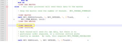

 I have noticed that every few runs my program hangs on the second MPI rank.
This Fortran program comes from Intel Community web site as an example of hybrid Open MP and MPI programming style.
Details:
env: Windows 10 Pro x64 21H1, Processor Intel(R) Core(TM) i7-8565U CPU @ 1.80GHz, 4 cores HT:ON,  ifort 2021.5.0, Intel MPI 2021.5
compilation command:  mpif90 -Qopenmp hybrid-hello.f90
run command: mpiexec -np 2 hybrid-hello.exe
Please share your thoughts how to get rid of these hangs.

We are able to reproduce your issue at our end by using the below command.
mpiexec -n 2 -genv OMP_NUM_THREADS=8 -genv I_MPI_PIN_DOMAIN=omp hybrid-hello.exe

We tried to check the correctness of your code using the below command:
mpif90 -check_mpi hybrid-hello.f90 -Qopenmp
mpiexec -n 2 -genv OMP_NUM_THREADS=8 hybrid-hello.exe --itc-args --check-tracing ON --itc-args-end
Using the above command, we encountered a deadlock as attached in the below log file(deadlock.txt).
Could you please try with the attached code(hybrid_hello_latest.f90) where we added: "!$OMP BARRIER" in line no:155 as shown in the screenshot?
We have tried at our end and it works fine. We also checked the correctness of the program which gave the expected results(output.txt)
Please let us know if this resolves your issue. If not, please get back to us.

 It works as expected after you added !$OMP BARRIER. Thank you very much.
