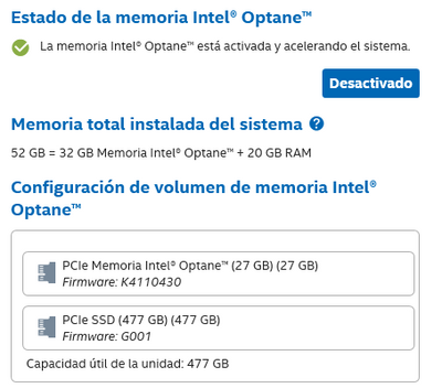

Hey, a few days ago i installed windows 11 on my laptop and my Intel Optane stopped working, dunno why.
I read multiple threads on different websites and checked multiple videos too, but i didn't find a solution since all the threads and videos basically explain the same: cmd -> disk -> select disk -> etc.... or delete metadata from some intel app or go to bios and set to non-optane... etc. These last 2 can't do them because my BIOS doesn't show that non-optane option and the app doesn't show the metadata option, the only thing i can do is set the SATA to RST with Optane and clear the optane (that cmd disk thing).
If it can be of help, my BIOS version is 311, Asus Utility - EZ Mode.
I found this thread  and is pretty much the same that is happening to me, but the accepted solution doesn't work for me (its seems that in that case is solved because the dude went to linux).
Here are some photos that i hope can give some help:

I went to the ASUS driver site and downloaded the V17.8 IRST, and its working right now
Thanks for the help!

It is possible that this error is related to the last partition of your Windows drive, or a problem with the Intel RST driver being used.
For the first option, it is important to leave 5MB of unallocated space as the last partition, in your case your system drive shows a recovery partition, which we may need to delete, or you may also reinstall the system, and partition the drive manually, leaving the 5MB.
Additional information here: https://www.intel.com/content/www/us/en/support/articles/000056917.html
Regarding the second option, try installing the latest Intel RST driver from the ASUS site, or try installing the Intel Optane Memory and Storage Management from the Microsoft Store App:
