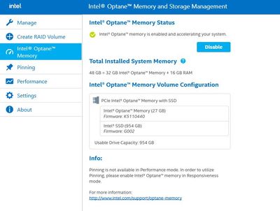

Hi There,
i have just installed an Optane Memory H10 on my gigabyte Z370M motherboard. I'm trying to figure if works fine. I have some screenshots here attached. Can someone help me out to figure how can i know if its working fine? Appreciate the help.

Based on your screenshots I can gladly confirm that everything is working fine, so acceleration is up and running now that both sections of the H10 have been paired together successfully as one "Optane Memory volume".

The SSU also shows that Optane acceleration is enabled:
- Storage: Intel Optane+954GBSSD
Regarding the task, I would like to confirm if this particular section of the article is also applicable for the Optane H10 version as I have seen this task being created mainly for standalone Optane Memory modules (like M10 or other), but please allow me to confirm and I will get back to you as soon as possible.

I had the chance to personally test a few Optane H10 builds today and I can confirm the following with you (MSI Z390 Gaming Edge AC):
1. A task is created when the Optane Memory was enabled in Responsiveness Mode:
2. If your Optane is running in "Performance Mode", a task is not created because the Optane software takes care of the optimization:
Taking into consideration your initial screenshots, your Optane acceleration should be enabled in Performance Mode, which matches what I mentioned in point 2, so your system is working in an optimal way and you do not have to worry about it.

Sorry for my late reply. Yes you're right the task scheduler only appears under pinning mode. with this i guess its all good. You may close this as resolved..Thanks a million.
