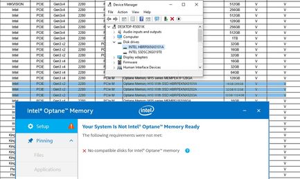

I bought intel optane h10 1tb/32gb variant.
I've tried every possible option but I just can't seem to get the optane working!
I read the forums, followed the steps according to the Drive Detection & Performance Troubleshooting Wizard.
Configured my BIOS to the exact settings
I have wiped and cleaned the optane drives with diskpart commands, Reinstalled Win10 numerous times.
But I still can't get the optane working. I get the "There are no valid disk pairs in your system"

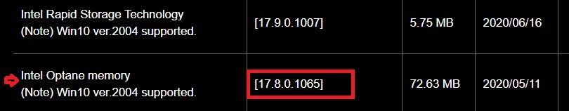

Looking at the user manual of the motherboard, it mentions the old Optane Memory interface, have you tried using this tool too?
Downloads page: https://www.gigabyte.com/us/Motherboard/Z390-AORUS-PRO-rev-10/support#support-dl-driver-sataraidahci
It would be better if you uninstall the existing RST driver and the Optane Memory and Storage Management, then install the Intel Optane Memory Software version 17.8.0.1065 seen in that picture, check if this changes the situation (this is option 1).
If the issue persists, check with the latest RST version from that same page, as you can see, it is 17.9.0.1007 (while our version is17.9.1.1009), so install the latest from the manufacturer (1007) and then install the Optane Memory and Storage Management from the Microsoft Store (this is option 2).

I have tried my motherboard's manufacturer latest drivers, I have tried intel's latest drivers. Nothing works. Every time I get the same error message in Intel Optane Memory and Storage Management, and in the about to be discontinued Intel Optane Memory app.

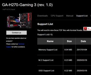

I tested an Optante H10 in a local Gibabyte motherboard that supports the regular Optane M10... I disabled the M10, removed it, installed the H10 and booted the system to check the message in the tool, and I get the same message, but this is an H270 motherboard, so I expected this to happen (The 256GB portion is recognized though).
I checked the supported M.2 file in the details page for this H270 motherboard and it includes the H10, but I'm sure this is not correct, looks like it is a general file since it is the same for the Z390...
