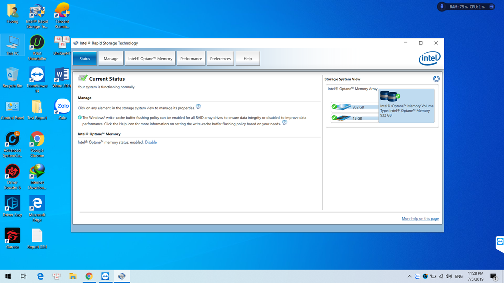

I use laptop ASUS S530UA BQ290T, plz help me

I want tell that i fixed success and i used Intel Optane Memory, xD
Thanks very much supported me.

Melvin_Li
4,053 Views
Hello JoshB_Intel,
I thank you for reminding me, xD
I'm sorry I forgot to reply @@
JosafathB_Intel
4,052 Views
Hello Melvin Li, Thank you for your reply, We are glad to hear that you were able to fix the issue you were experiencing by following the steps provided by your OEM. We will proceed to close this case. Please do not hesitate to contact us back if you need further assistance. Have a nice day. Best regards, Josh B. Intel® Customer Support Technician Under Contract to Intel Corporation
