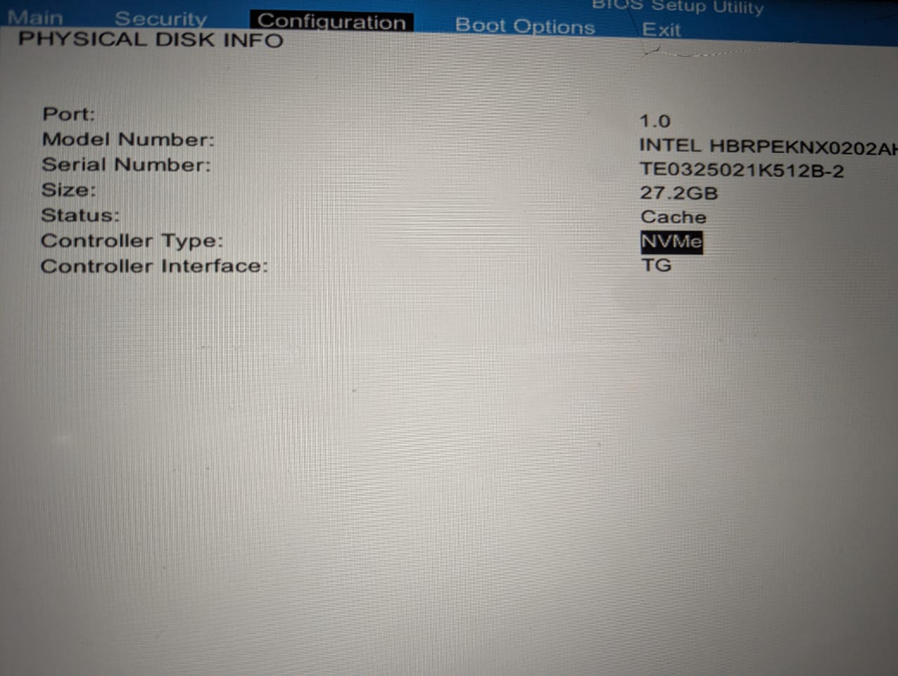

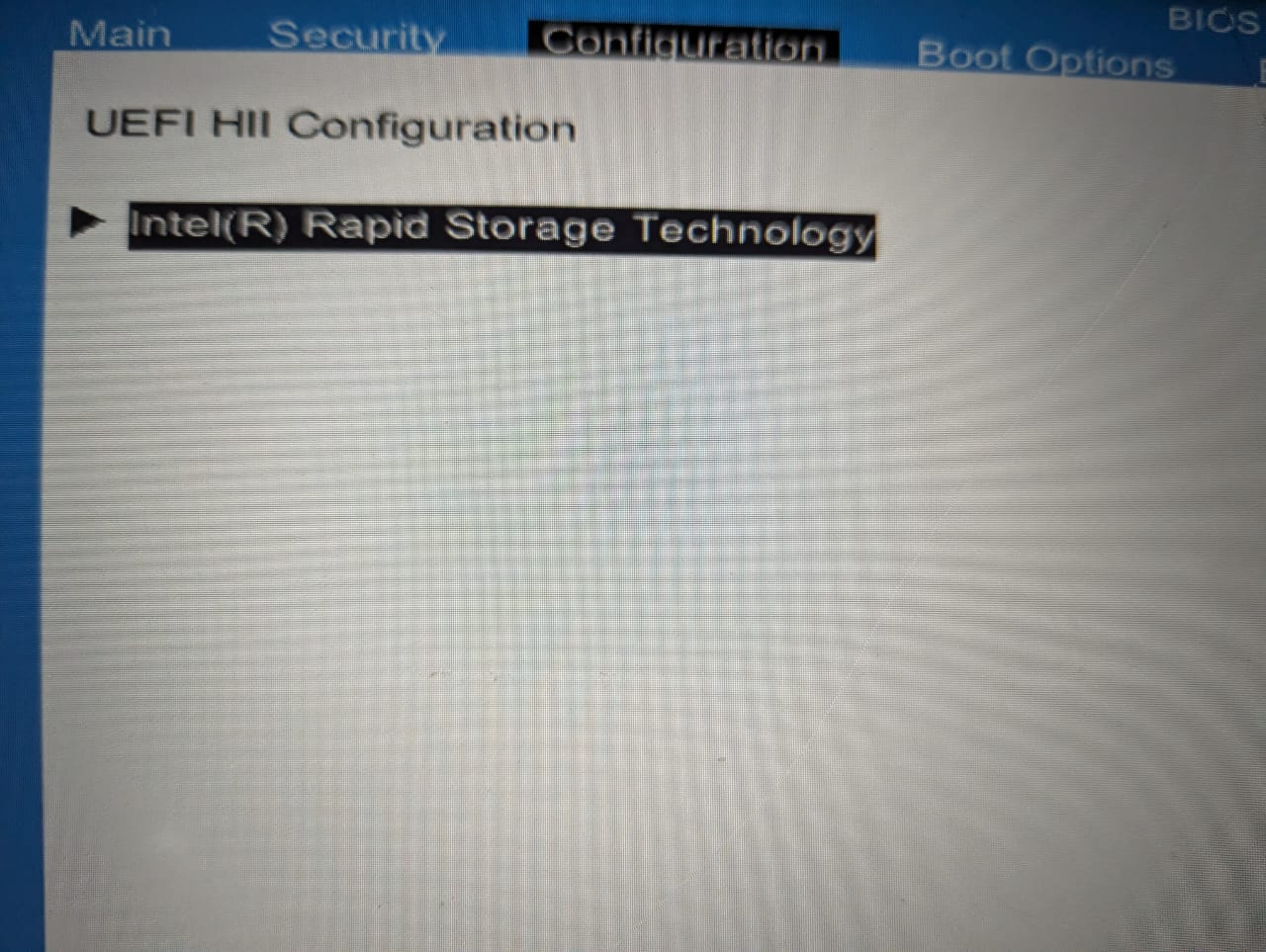

I want to give some information about the genesis of the problem.
I turned on my PC a few days a ago and it took a long time to boot up. After which I get a BSOD with the error:
`DRIVER_PNP WATCHDOG`
All efforts to boot into recovery failed. I also tried using a bootable USB but the drivers for the SSD failed to install so I couldn't access it.
As a result, I had to change my SSD. Which brings me to the point where I want to restore my data from the old SSD.
I have attached some images here showing the BIOS info for the Intel Optane SSD and the newer Samsung SSD.
Intel
Optane Mode Detail Intel SSD.jpeg : showing that it's an Intel Optane Volume.
Optane Mode Intel SSD.jpeg: showing the Optane Volume Info
Intel SSD NVME Main: The SSD portion of the Optane Volume
Intel SSD Cache: The cache portion of the Optane Volume
Samsung
Samsung SSD Mode: Showing overview of the SSD
Samsung SSD: Showing the volume info
Samsung SSD Details: Showing the SSD portion of the volume.
From the above, I can tell the PC is Optane compliant, but I am not sure how to get the PC to see the old SSD when connected via USB.

From the BIOS, I would use that DISABLE selection and disable the cache. This will write everything in the cache to the SSD portion. Once that is done (and presuming it works; it may fail if it is the SSD itself that is the failing component), you should be able to access the SSD portion from Windows and extract your files.

Thanks a lot! @n_scott_pearson
The solution worked.
I disabled the cache on the old SSD using the BIOS, and the laptop booted normally.
I am not sure what went wrong initially. Probably the cache was corrupted.

Good - but understand that what you've done is pushed the cache out of the way and left the slower SSD portion running.
First thing you should do is an integrity check on the SSD. Run a "chkdsk x: /f", where 'x' is the drive letter assigned to the SSD. If you are booting from this SSD, this may need a reboot before the scan will be performed (it should ask for this).
Once everything looks good, you could go back into BIOS and try reenabling the cache. If this is successful, you may be able to get back to where you were before the incident occurred.
