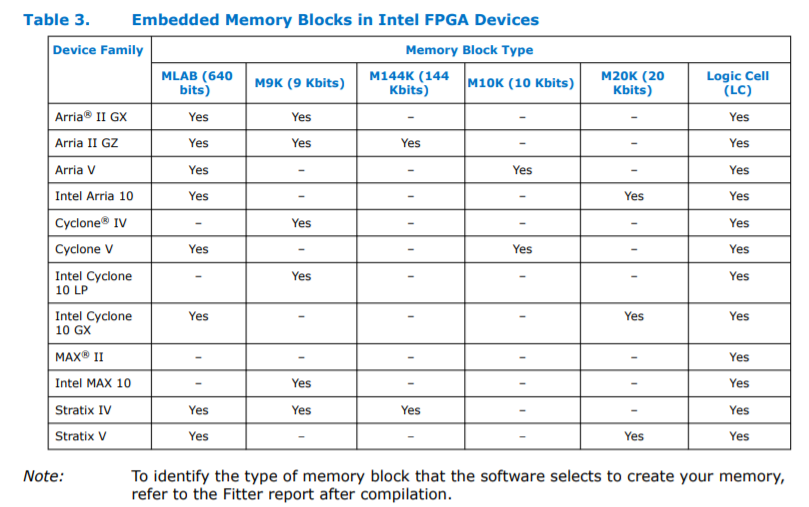

Yes. There is a RAM: 2-PORT IP to support Simple dual-port RAM and True dual-port RAM. You may refer to the supported device below:
Doc: https://www.intel.com/content/dam/www/programmable/us/en/pdfs/literature/ug/ug_ram_rom.pdf
