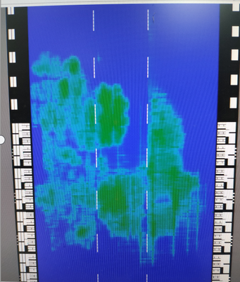

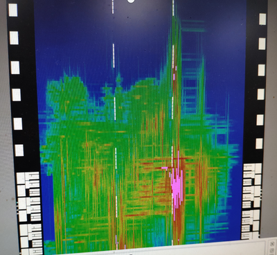

2,747 Views
Hi Deshi,
     Because that if I want to use newest software, I need to apply for software installation.
      Continue to above problem,
      I found that the routing hotspots is different for the pof file got from V16.0 and V18.0, as follow two pictures :
      v18.0
V16.0
From above two picture,  the routing hotspots got from V16.0 is better compared to the one got V18.0 (many part exceeds 95%), I compared the advanced settings of these two version software:

    So, For V18.0, I closed the "Allow register Dupilation" and "Allow Register Mergin" Item, but the routing hotspots change more worse.
    Could you tell me the difference for the complication between V16.0 and V18.0, and is there solution for that I can got the routing hotspots (got V18.0) same as V16.0?
