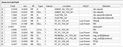

Also, I used ff* instead of lc* because that's part of the data path as shown in timing analyzer:
You can also see that the location setting I had set are reflected on here.
