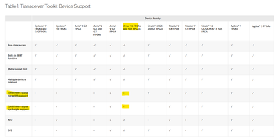

We would like to see and check the eye diagram of our display port inputs that are connected to transceivers.
We've assumed that the transceiver toolkit (eye viewer) may help us in this manner but the table which is given in the below link says that Arria 10 FPGAs are not supported.
Quartus® Prime Software Features Transceiver Toolkit
So, is there any way to see the eye diagram of our transceiver input ?

If you check TTK supported website for Altera FPGA, the eye viewer is not supported for Arria 10 device.
https://www.intel.com/content/www/us/en/software/programmable/quartus-prime/transceiver-toolkit.html
Alternatively, I suggest you to use BER features in the Transceiver Toolkit to fine tune your design PMA setting.
