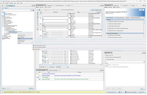

Hi Professionals,
I am trying to generate my ARRIA10 SoC Development kit in Platform Designer.
When I click on the a10_hps - > System Info:
Component Instatiation: a10_hps
IP File: (NONE)
I have tried to install different kinds of Tools, Folders etc. but nothing changed.
Further I allways get the Warnings:
Warning: File path could not be determined for component altera_arria10_hps in C:/Projects/DLR_C10303/DLR_BSR_Modem_FPGA_P2254/Dokumentation/Software/FPGA/FPGA_BSR_Projects/BSRFPGA_SW_V10/qsys_top.qsys. The component is ignored for generation.
Warning: qsys_top.a10_hps: HPS model no longer supports simulation for HPS FPGA Bridges.
Warning: a10_hps: HPS model no longer supports simulation for HPS FPGA Bridges.
Warning: a10_hps.f2h_irq0: Cannot connect clock for irq_mapper_001.sender
Warning: a10_hps.f2h_irq0: Cannot connect reset for irq_mapper_001.sender
Warning: a10_hps.f2h_irq1: Cannot connect clock for irq_mapper_002.sender
Warning: a10_hps.f2h_irq1: Cannot connect reset for irq_mapper_002.sender
When I try to open:
ip/qsys_top/qsys_top_hps_0.ip
I get:
Error: altera_hps: couldn't read file "C:/altera_pro/25.1.1/quartus/../ip/altera/alt_mem_if/alt_mem_if_interfaces/alt_mem_if_hps_emif/common_hps_emif.tcl"
(file line 2)
invoked from within
"source "$env(QUARTUS_ROOTDIR)/../ip/altera/alt_mem_if/alt_mem_if_interfaces/alt_mem_if_hps_emif/common_hps_emif.tcl""
(file "C:/altera_pro/25.1.1/ip/altera/hps/altera_hps/altera_hps_hw.tcl" line 42)
Tools I use:
- Quartus Prime Pro 25.1.1 with Licence
- Arria 10 device Support
- EDA Libraries
How do you generate your a10_hps Projects?
And How do I get a valid a10_hps into the catalog?
Thanx for your help.
I am going crazy aufter 3 Weeks of trying and installing.
Greez Linus

Have you tried deleting and re-adding the HPS IP to your Platform Designer system?
LinusGrun
2,041 Views
Hi Sstrell,
thanx for your reply!
Yes, I added new Hard Processor System FPGA IP from the IP Cataloge to the Project.
I further made a new Project and only added a new Hard Processor System FPGA IP from the IP Cataloge. This I have been able to Generate HDL.
But in both cases in the arria10_hps_0 System Info there is:
Component Instantaion: arria10_hps_0 IP File: (None)
I realized when I start Quartus Prime the Window "Evaluation Mode" opens and says I have e.g. 17 Days remaining.
Here I choose License Setup and choose my License.
Might this be the Problem? It Starts in Evaluation Mode?
And how do I get in normal mode?
I have just installed the hole Package again... But nothing changes.
I am looking forward to your answers.
Thanx.
Linus

LinusGrun
1,970 Views
I tried a lot again and it is so frustrating.
So add some screenshots for you.
Maybe someone can see the problem.
Many thanks in advance.
Greez Linus
sstrell
1,875 Views
Your screenshots are too low res to see anything on them.
You probably need to generate a license file and license Quartus since you are using Pro.

I also realized this recently that there is no .ip file for the HPS itself, but all the HPS related parameters can be found in .qsys file of the project. No ideas why though..

I would not ignore that warning, but yeah there shouldn't be any .ip or .qip file necessary for the HPS. I can't tell much because the picture quality is low and I can't read..

Sorry for the delay in response as I just got back to office, I tested on Quartus Pro Linux 25.1.1, 25.1 , 24.3, 23.3 and I can see the same behavior whereby IP file is listed as none for Arria 10.
I checked our internal database and saw there was a case note that mentions Arria 10 altera_arria10_hps ships the HPS content as .qsys hardware project file instead of .ip file (similar to older devices eg. Cyclone V). For newer devices such as Stratix 10 , Agilex 7 onwards, the approach is to ship the HPS as a modular IP component with separate HPS IP releases for Platform Designer instantiation.
Just FYI , there is Arria 10 GSRD user guide on generating the gsrd and other files
https://altera-fpga.github.io/rel-25.1.1/embedded-designs/arria-10/sx/soc/gsrd/ug-gsrd-a10sx-soc/#compiling-hardware-design
Note: for gsrd, the repo https://github.com/altera-opensource/gsrd-socfpga is no longer updated after 24.3, the new repo is this https://github.com/altera-fpga/arria10-ed-gsrd
(will be updated in the document)
Also discussed with our factory team to confirm that the warning(Warning message :-  “Warning: File path could not be determined for component altera_arria10_hps in xxx.qsys. The component is ignored for generation.") could be safely ignored.
Anyway, I noticed that by disabling the Parallel IP generation, it will remove the warning message on the File path could not be determined.
