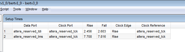

Hi, I'm looking to investigate the setup times for a design I have. However, despite following AN 775 as best I as I can, I am not generating any outputs from my design. Instead all I see are two Data ports which I haven't declared myself in my design...

module bertfront( input clk, input inbitstream, input [1:0] control, //[1] start, [0] reset output outbitstream, output reg ledstatus, output reg [31:0] totalbits, output reg [31:0] incorrectbits );
Can anyone shed some light as to why I'm not seeing my own data ports in the timing analysis? If you need any more code I would be happy to share the entire project.

Hi Ted,
When we debug your design with the JTAG interface, the JTAG signals TCK, TMS, TDI, and TDO are implemented as part of the design.
The altera_reserved_tck/tms/tdi pin is automatically generated for a design that uses a JTAG accessible module such as the Nios II debugger, SignalTap II logic analyzer, and In-System Memory Content Editor.
For timing constraint those pins
To constrain this JTAG clock, apply a 33-MHz clock constraint to this pin.
For the TimeQuest Timing Analyzer, use the following command:
create_clock -period "30.303 ns" -name {altera_reserved_tck} {altera_reserved_tck}

Let me know if this has helped resolve the issue you are facing or if you need any further assistance.
