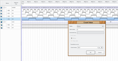

Below is my code
module simple_circuit(F,A):
input [0:3]A:
output [0:1]F;
assign F[0] = A[0] || A[1]&&A[2] || A[1]&&A[3];
endmodule
Then I used University Program VWF,
Insert the node, and choose A as count value signal, it crash.
ShengN_Intel
1,632 Views
You can't use count value "count every" on bundled signals in vector waveform simulator. That only works on single bit signal. Check image:
Sheng

ShengN_Intel
1,620 Views
The function worked well in older version Quartus II. Tested in Quartus II 15 and 13. Quartus II 13 is still downloadable in FPGA Software Download Center. As vwf is generally older version simulator for Quartus II. For Quartus Prime, it's recommended to use modelsim/questasim simulator for more functionality.
