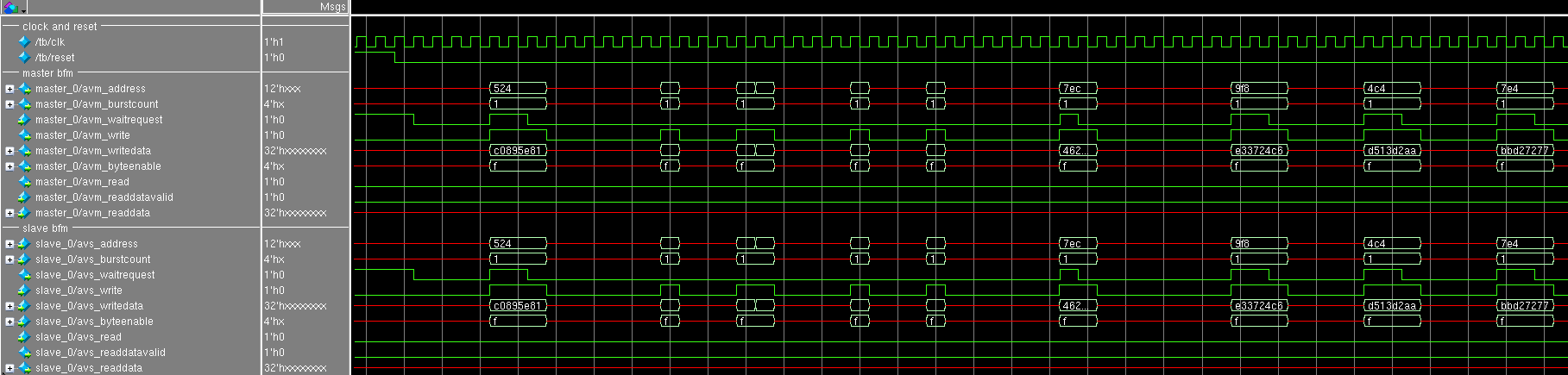

I have a simple ArriaV based design using Quartus 21.1 that has a JTAG Master and BFM Master (for simulation).  I am using a custom SPI module design that has a simple Avalon Slave interface.  In my IP and my ip_hw.tcl I have the waitRequest listed as a slave signal.
When simulating this I can see my IP generated waitRequest is not making it o the BFM Master. Other Altera IP are generating this signals and propagating it to the BFM Master.
What are the required "properties" and "attributes" in the ip_hw.tcl file that request this connectivity from the Interconnect Builder?

When you say that waitrequest is "not making it" to the host, what do you mean?  Can you show your simulation waveform?
ThomasTessier
1,741 Views
The Blue Circle is showing wait_request occurring at the Avalon Master BFM when I read/write to an Altera GPIO block.
The Red Circle is showing my custom SPI controller generating wait_request but it never makes it to the Avalon Master BFM pins.

The interconnect may not be passing the waitrequest to the host because the host is not trying to access your agent component if I'm looking at the simulation correctly.  There's no need for the interconnect to stall the host from accessing your agent if the host is not actively trying to access your agent.  Remember waitrequest input to a host completely stalls the host.  If the host wants/needs to access other agents, the interconnect is not going to stall it even if a particular agents is manually asserting waitrequest.

Compared the posted simulation with the design example simulation (check image below), I noticed there're some differences between slave_write (posted simulation) and avs_write (design example simulation). The avm_waitrequest will be asserted and avm_writedata will only begin transferred during REQ_WRITE (write request) where avm_write will be '1'.

One more thing is make sure there's proper wire connection between avm_waitrequest and slave_waitrequest like the .v file attached below. For example,
.avm_waitrequest    (master_0_m0_waitrequest),
.avs_waitrequest     (master_0_m0_waitrequest),
Similar problem is encountered if there's no proper wire connection.
