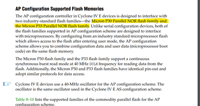

However, yesterday I found out in the Generic Flash Quartus Programmer User Guide that Cyclone IV only supports 3-bytes addressing.
Hence I concluded (and may be you can confirm ) that the flash of 256 Mb size from ISSI is simple not compatible with the Cyclone IV.
Is there a way around this?
I can try to program the flash to use 3-byte addressing, however in this case the flash size should be 128 Mb. Is there a trick to achieve that the tool (Quartus programming tool) takes it as a 128 Mb flash and not a 256 Mb flash?

Sorry for the delay in response as we had an access issue earlier this week in the community forum. Yes, Cyclone IV only supports 3-bytes addressing. Besides, there's no trick to use a 256Mb flash device as 128Mb.
Hope this clarifies your concern.

We are waiting for the new hardware.  However, we are bound to use a 256 Mb ISSI flash with this Cyclone IV due to some other things stored in this flash as well, which require a large capacity flash.
Since the flash is connected to a microcontroller as well, we will try to configure the flash to boot in 3-bytes addressing mode and in that case the Cyclone IV "should be" able to boot from it.

I regret to inform you that the ISSI flash is not supported nor has it been tested with the Cyclone IV, and it is recommended that you refer to the user guide (Page 186), which specifies that only Micron flash devices are supported.
