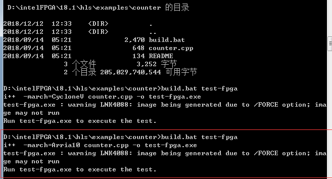

I run the example as the HLS Compiler Getting Started Guide, but occur a warning LNK4088. Do you meet this warning?

This error message may appear if you are building an HLS design for FPGA on Windows:
warning LNK4088: image being generated due to /FORCE option
This is a known issue, but it does not affect your design. Your *.exe should still run correctly.
Hope this helps.
