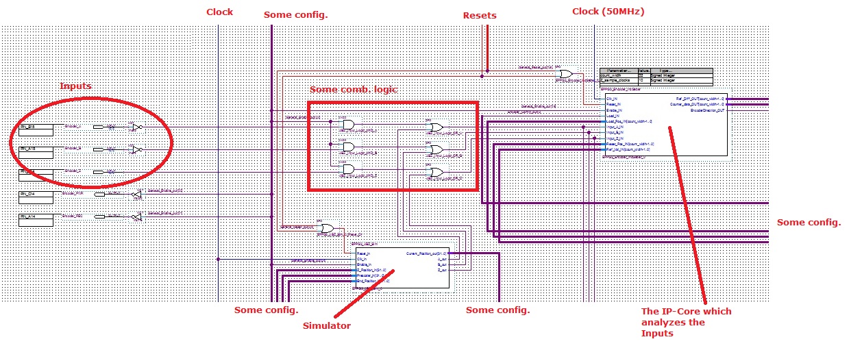

I'm running mad with this:
I've got tree inputs of asynchronous Signals. These Signals are the ABZ-Signals of a device which meassures a movement (I just don't know how it is called in english, sorry).
After the signals arrive in my design, I have to digitally filter them:
Dig_Filter: process (Clk_IN, Input_A_IN, Input_B_IN, Input_Z_IN, sig_A, sig_B, sig_Z, sig_Filter_A, sig_Filter_B, sig_Filter_Z) begin if (falling_edge(Clk_IN)) then sig_Filter_A(0) <= Input_A_IN; sig_Filter_A(1) <= sig_Filter_A(0); sig_Filter_A(2) <= sig_Filter_A(1); sig_Filter_A(3) <= sig_Filter_A(2); sig_Filter_A(4) <= sig_Filter_A(3); if (sig_Filter_A = "11111") then sig_A <= '1'; elsif (sig_Filter_A = "00000") then sig_A <= '0'; else sig_A <= sig_A; end if; sig_Filter_B(0) <= Input_B_IN; sig_Filter_B(1) <= sig_Filter_B(0); sig_Filter_B(2) <= sig_Filter_B(1); sig_Filter_B(3) <= sig_Filter_B(2); sig_Filter_B(4) <= sig_Filter_B(3); if (sig_Filter_B = "11111") then sig_B <= '1'; elsif (sig_Filter_B = "00000") then sig_B <= '0'; else sig_B <= sig_B; end if; sig_Filter_Z(0) <= Input_Z_IN; sig_Filter_Z(1) <= sig_Filter_Z(0); sig_Filter_Z(2) <= sig_Filter_Z(1); sig_Filter_Z(3) <= sig_Filter_Z(2); sig_Filter_Z(4) <= sig_Filter_Z(3); if (sig_Filter_Z = "11111") then sig_Z <= '1'; elsif (sig_Filter_Z = "00000") then sig_Z <= '0'; else sig_Z <= sig_Z; end if; else sig_Filter_A <= sig_Filter_A; sig_Filter_B <= sig_Filter_B; sig_Filter_Z <= sig_Filter_Z; sig_A <= sig_A; sig_B <= sig_B; sig_Z <= sig_Z; end if; end process Dig_Filter;
This is all what is done to the ABZ-Signals.
And this is my Problem:
I always get the Warnings:
Warning (332060): Node: Encoder_A was determined to be a clock but was found without an associated clock assignment.
Warning (332060): Node: Encoder_B was determined to be a clock but was found without an associated clock assignment.
Warning (332060): Node: Encoder_Z was determined to be a clock but was found without an associated clock assignment.
(Encoder_A /B /Z are the Input Pins)
I have tried to use the "set_false_path" assignment, but the Warnings didn't vanish. Quartus and TimeQuest always analyze them as Clocks.:mad:
How can I get rid of this stupid clock determination? I just want them to be simple Inputs and no clocks anymore.
Steffen

Hi kaz,
I mentioned Encoder_A, _B and _Z. These are the names of the Pins feeding the Input Ports Input_A_IN, Input_B_IN and Input_Z_IN.
But I've forgotten something:
In the Path from the Input-Pins (Encoder_A /_B /_Z) to the Input Ports (Input_A_IN, Input_B_IN and Input_Z_IN) of the Code above are an AND and an OR to switch off the Signals from the Input-Pins and activate a simulator which is capable of generating the ABZ-Signals internally (For testing purposes).
https://www.alteraforum.com/forum/attachment.php?attachmentid=8594

Hmmm, Code, you want code. OK here is all I can give you:
https://www.alteraforum.com/forum/attachment.php?attachmentid=8595
As I see it NOW:
The three wires which are leading down from the ABZ-Wires, goto some counters, which are counting the POSITIVE EDGES of the Signals.
MEA CULPA
This is why Quartus thinks these are clocks.
OK, in this case I have to change the counters to sample the Inputs and counting a change in a 2Bit shift-register.
Sometimes speaking about a Problem helps also to solve the Problem.
