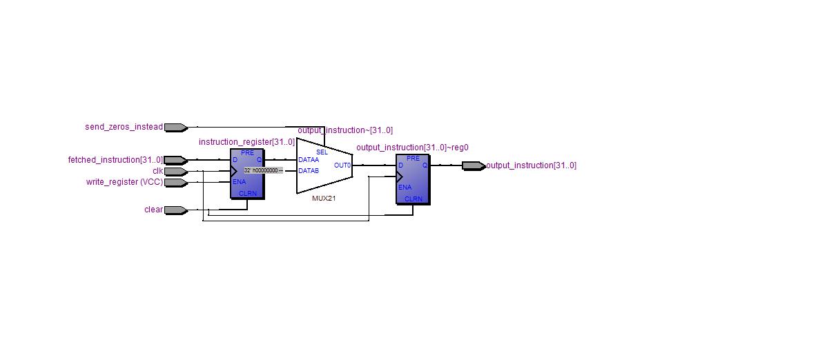

You are right, in terms of me being unknowledgeable in VHDL. But I found another issue. In the RTL viewer it shows that there are 2 registers. I will show you the code and the jpeg I got from the RTL viewer. I am wondering how I can remove the second register.
Here is the code:
library IEEE; use IEEE.STD_LOGIC_1164.ALL; entity IF_to_ID_registers is port ( fetched_instruction : in std_logic_vector(31 downto 0); clear: in std_logic; write_register : in std_logic; send_zeros_instead : in std_logic; clk : in std_logic; output_instruction : out std_logic_vector(31 downto 0) ); end IF_to_ID_registers; architecture Behavioral of IF_to_ID_registers is signal instruction_register : std_logic_vector(31 downto 0); begin process(clk) begin if clear = '1' then output_instruction <= (others => '0'); instruction_register <= (others => '0'); elsif rising_edge(clk) then if write_register = '1' then instruction_register <= fetched_instruction; end if; if send_zeros_instead = '1' then output_instruction <= (others => '0'); else output_instruction <= instruction_register; end if; end if; end process; end Behavioral;
Thank you for your help
EDIT: Also is there a way I can make the write level based, and the read edged based. I am getting some very nasty timing issues in modelsim.
Altera_Forum
5,214 Views
You have asked for two register stages:
fetched instruction => instruction_register then
instruction register => output_instruction.
If you just want one stage then remove instruction_register and assign input to output directly

But by doing that, I can't use send zeros properly. I order for it to be right, the registers output has to be multiplexed with the send_zeros_instead as the selector. How would I get that done
