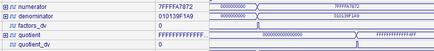

If you check the simulation, the 0xFF..FFF4FF is under 010139F1A9h.
However in signal tap, you're checking under 010131CEB9h.
May be use other trigger condition to trigger the 0xFF..FFF4FF under 010139F1A9h, may be use transitional.

Hi Sheng, thank you for the answer. The 0xFF..FFF4FF (quotient) output is under 010139F1A9h (denominator) and 7FFFFA7872h (numerator) in the simulation because I've simulated the divider standalone in order to check its behavior feeding the IP only with those operands. In HW the divider is part of a more complex design and it is fed in pipeline with a stream of operands. That's the reason why in SignalTap you also see the subsequent operands, but the 0xFF..FFF4FE is the result of the first two operands of the stream, that are the same of the simulation:  LPM_DIVIDE_Simulation_vs_SignalTap.PNG

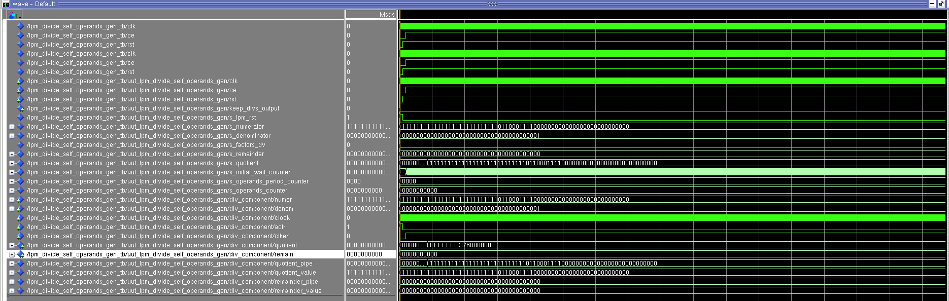

For signal tap, i can get the same result as you.
However for simulation, i use your testbench and modelsim but i can't get the same result as you check attached pic. It keeps the same at FFFFFFEC78000000. Is there anything i miss?

Reduce the following constant:
constant INITIAL_WAIT : natural := 200000000; -- 2 seconds
to
constant INITIAL_WAIT : natural := 200000; -- 2 seconds
otherwise the simulation will wait 2 seconds before starting to generate the operands. Attached the updated code, with the initial_wait reduced.
