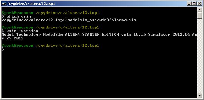

Hmm, type "which vsim" on the command line.
It should be to a path that includes modelsim_ase, eg., something like
...altera/12.1sp1/modelsim_ase/win32aloem/vsim
I'm wondering if you accidentally installed the Altera Edition, rather than Altera Starter Edition ...
Try the command "vsim -version" too, perhaps that'll provide the version even without the license file being valid.

I wondered the same thing, but it appears I do have the correct version installed (see attachment).
The only other advice I have found so far is that I may need to install the software as Administrator -- though my normal account is an administrator account. I might try that if I can't get it to work otherwise.

Thanks for getting back. I've confirmed the most obvious things (see included screen shots), and tried a multitude of other
combinations. Installing as Administrator made no difference. I've tried the 12.1SP1 variant and several other builds with and
without various service pack inclusions. Always done on a fresh install of XP-SP2 (and SP3). All with the same negative result.
