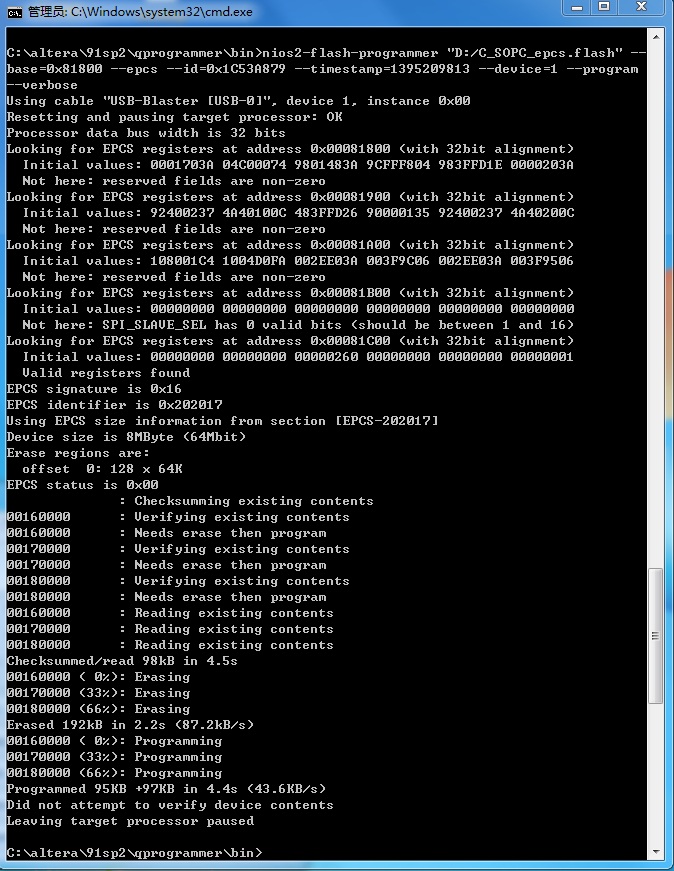

After open the cmd.exe, I run 3 commands to program to EPCS on a stand-alone computer.
1.//Location of nios2-flash-programmer.exe
cd "C:\altera\91sp2\qprogrammer\bin
2.//program .flash of sof2flash.
nios2-flash-programmer "D:/C_epcs.flash" --base=0x81800 --epcs --id=0x1C53A879 --timestamp=1395209813 --device=1 --program --verbose
3.//program .flash of elf2flash.
nios2-flash-programmer "D:/C_SOPC_epcs.flash" --base=0x81800 --epcs --id=0x1C53A879 --timestamp=1395209813 --device=1 --program --verbose
Some picture as follow:
https://www.alteraforum.com/forum/attachment.php?attachmentid=8677
And I find some errors like:
Initial values: .........
Not here: reserved fields are non-zero.
I donot kown why.
Altera_Forum
2,134 Views
You say you have 2 files to download to EPCS, don't you ?
C_epcs.flash to configure the FPGA
and C_SOPC_epcs.flash is your embedded NIOS II program.
BUT you try to write the both at the same address in EPCS.
Your FPGA configuration C_epcs.flash whould be at address 0x00
Your embedded software should be located after the FPGA configuration.
look at documentation of nios2-programmer, flash to epcs converter, generation of .pof file (specially to epcs)... They describe how to insert software program after the FPGA configuration.
