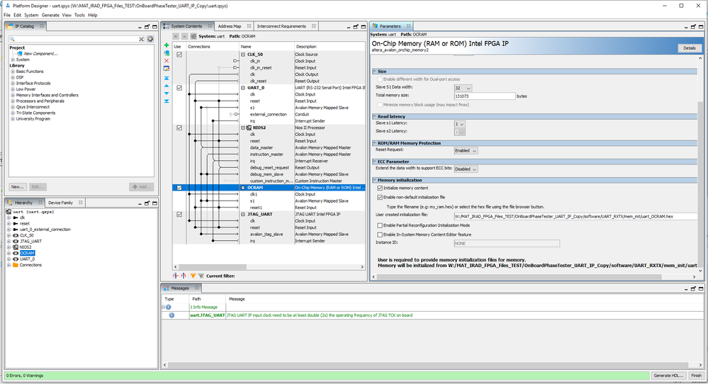

I am trying to integrate UART (RS-232 Serial Port) Intel FPGA IP into my project on a DE10-Nano with a Cyclone V SoC. I have followed the CVSOV UART example from the design store and I have gotten to the point to where I am trying to call the HDL created by the platform designer into my top level code. However, when i try to compile my project I get a popup saying that Quartus Quit Unexpectedly and I do not get an actual error code at all. Furthermore, when I remove the line of code which calls the HDL for the UART generated by the platform designer the code will compile.

I was able to get the project to compile after decreasing the total memory size in the On-chip Memory IP in platform designer. I decreased the memory from about 130000 bytes to 100000 bytes and this seemed to work.

I had already tried to delete the db folder but I had not tried to delete the incremental _db folder. I did make some changes in the platform designer in the on chip memory IP. The changes were that I changed the name of the IP's in the platform designer to follow the Max Baud Rate Cyclone V SOC Design Example and I changed the On chip memory initialization so that it does not initialize memory content. this allowed the program to compile but It does not allow for the use of the nios ii code I am using.

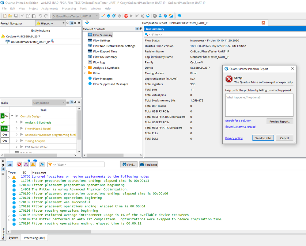

With that same project I still get the same error as shown below. To be sure I re downloaded the project from the file I posted above. I have deleted the db and incremental_db and I have tried compiling with no other programs running in the background. The only thing that I have been able to do to stop this error from happening is to comment out line 18 in the top level V file or to go into the platform designer in the on chip memory module under memory initialization and un-check "Enable non-default initialization file" and "Initialize memory content". My assumption is that in order for the UART IP to work I need those two boxes to be checked. Is that assumption correct? Could there be any potential problems in where I have it saved or possibly my compilation settings as well? We are running the same version of quartus.

Okay, Please click on preview report and attache it.
VROGE2
3,830 Views
Here it is:
Problem Details Error: Internal Error: Sub-system: U2B, File: /quartus/db/u2b/u2b_av_m10k_param.cpp, Line: 2085 ram_content_index < ram_content.size() Stack Trace: 0x10426: U2B_AV_M10K_PARAM_TRANSLATOR::translate_eram_bitvec + 0x5f6 (db_u2b) 0xf2cf: U2B_AV_M10K_PARAM_TRANSLATOR::convert_config_to_physical_atom + 0x12f (db_u2b) 0xcfb4d: U2B_TRANSLATOR_AV_M10K::convert + 0x9d (db_u2b) 0x349d5: FSV_U2B_POSTFIT::check_u2b_configs_for_conflicts + 0x585 (fitter_fsv) 0x396b9: FSV_U2B_POSTFIT::work + 0x139 (fitter_fsv) 0x601ca3: vpr_qi_u2b_postfit_work + 0xc3 (fitter_vpr20kmain) 0x270376: aa_flow_finalize + 0x66 (fitter_vpr20kmain) 0x26b25d: aa_flow_fit + 0x20d (fitter_vpr20kmain) 0x5735ae: VPR_QI_FACADE::vpr_qi_main + 0x6e (fitter_vpr20kmain) 0x3384e: fitapi_run_vpr + 0x7e (fitter_fitapi) 0x1fb8f: FSV_EXPERT_BASE::run_vpr + 0x13f (fitter_fsv) 0x1f64d: FSV_EXPERT_BASE::place_and_route + 0x12d (fitter_fsv) 0x1eab6: FSV_EXPERT_BASE::invoke_fitter + 0x636 (fitter_fsv) 0x1c952: fsv_execute + 0x22 (fitter_fsv) 0xe910: fmain_start + 0x900 (FITTER_FMAIN) 0x41b1: qfit_execute_fit + 0x1bd (comp_qfit_legacy_flow) 0x5384: QFIT_FRAMEWORK::execute + 0x2a0 (comp_qfit_legacy_flow) 0x267f: qfit_legacy_flow_run_legacy_fitter_flow + 0x1c7 (comp_qfit_legacy_flow) 0x14410: TclInvokeStringCommand + 0xf0 (tcl86) 0x161e2: TclNRRunCallbacks + 0x62 (tcl86) 0x17a65: TclEvalEx + 0xa65 (tcl86) 0xa6f8b: Tcl_FSEvalFileEx + 0x22b (tcl86) 0xa5646: Tcl_EvalFile + 0x36 (tcl86) 0x12606: qexe_evaluate_tcl_script + 0x376 (comp_qexe) 0x11864: qexe_do_tcl + 0x334 (comp_qexe) 0x16755: qexe_run_tcl_option + 0x585 (comp_qexe) 0x380c3: qcu_run_tcl_option + 0x1003 (comp_qcu) 0x160aa: qexe_run + 0x39a (comp_qexe) 0x16e51: qexe_standard_main + 0xc1 (comp_qexe) 0x2233: qfit2_main + 0x73 (quartus_fit) 0x12e98: msg_main_thread + 0x18 (CCL_MSG) 0x1467e: msg_thread_wrapper + 0x6e (CCL_MSG) 0x16660: mem_thread_wrapper + 0x70 (ccl_mem) 0x12761: msg_exe_main + 0xa1 (CCL_MSG) 0x287e: __tmainCRTStartup + 0x10e (quartus_fit) 0x17973: BaseThreadInitThunk + 0x13 (KERNEL32) 0x6a270: RtlUserThreadStart + 0x20 (ntdll)   End-trace     Executable: quartus_fit Comment: None   System Information Platform: windows64 OS name: Windows 10 OS version: 10.0   Quartus Prime Information Address bits: 64 Version: 18.1.0 Build: 625 Edition: Lite Edition

Hi Van,
It looks like internal error but however not replicate-able, If possible share complete design.
or
Try using Quartus Lite latest version 19.1.
We can see such error reported on Quarts v13.
https://www.intel.com/content/www/us/en/programmable/support/support-resources/knowledge-base/solutions/rd07042013_838.html
