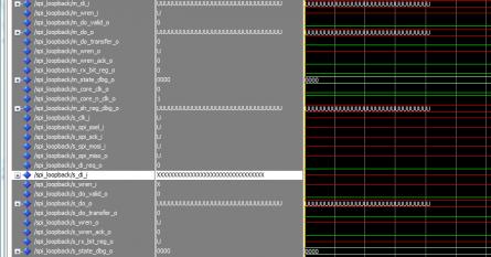

Dear All,
I am trying to simulate the testbench of the master and slave SPI interfaces from the opencores.org website but I get the following error message:
error (10533): VHDL wait Statement error at spi_loopback_test.vhd(209): wait Statement must contain condition clause with until keyword
I am using Quartus for the VHDL files and Modelsim to view the testbench results. Also, I have set the "spi_loopback_testbench.vhd" file as the "Top-Level Entity".
I will appreciate it if anyone can help me figure out how to solve the error. Please find the files attached.
Thank you.
Kind regards,
Deadman

You don't set the testbench as the top-level entity for Quartus to compile but the actual top-file you are going to simulate, in this case 'spi_loopback.vhd'.

I simulated the "spi_loopback.vhd" file and I get errors on the test bench as shown in the picture below. I am not sure why I am getting these errors.http://www.alteraforum.com/forum/attachment.php?attachmentid=10010&stc=1

Unfortunately the image to small to read, even with my 'computer glasses' :)
Perhaps you can archive the project and either post the .qar here or send it to my private message box.
Josy
