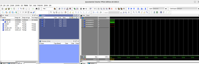

I have a project called HACK (an attempt to create Nand2Tetris' project in an actual FPGA board). It has the following pertinent files:
halfAdder.vhd
testHalfAdder.vhd
HACK.vhd
testHalfAdder is a testbench that instantiates the halfAdder component and tests it. HACK instantiates halfAdder in a way that doesn't actually make any sense, but just to force it to be compiled for now.
After creating halfAdder.vhd, I created halfFullAdder.vhd and added it to quartus testbenches list via Assignments->Settings->Simulation. I also checked the box to make simulation run automatically after compilation.
If I set halfAdder.vhd to be the top-level entity, everything runs fine and my simulation works. If i then set my top-level entity to be HACK, then the overall compilation works, but the simulation shows only undefined signals and exits with an error.
Am I doing something wrong or is this a bug? If I'm doing something wrong, how to correct it?
Thanks so much for any help.

halfAdder working simulation:
halfAdder broken simulation after setting HACK to top level entity:

HACK.vhd is not a testbench.  All it does is instantiate halfAdder.  It doesn't provide any stimulus to halfAdder so you won't see anything in a simulation.

I see, I thought that testbenches were supposed to be always compiled and instantiated, but it seems that is not the case.
After you pointed me to the right direction i researched a bit and it seems the common practice is to simply define the desired testbench as a top-level entity when you want it to compile and run(?)

Correct.   A testbench is a top-level design that instantiates a DUT and usually has no top-level I/O since it does not need to be implemented in hardware through synthesis.  The reference to compilation here is that it must be able to compile in the simulation tool, not necessarily in the synthesis tool (Quartus).
