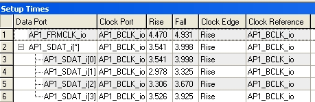

Hello, I have to do a specification for setup and hold time for all my input signals in the FPGA.
I found with Timequest that we can do a "Report datasheet". But it's hard to understand the result...there is 2 number...
For example, with the Report datasheet setup time report, I have a rise and a fall value...and a column that say the clock edge. What mean rise and fall time when clock edge is already in a column?
To do my datasheet, if the column clock edge is Rise I use the setup time in the Rise column? If it's that why the other column is there for "fall"?
Last thing : I have 2 component that use similar kind of input, AP0 and AP1. But in the Report datasheet, AP0 never appear, why? (see picture)
Everything works fine for both component so AP0 has not disappear in synthesis...

The rise/fall times account for rising and falling delay differences in transistors of the device, not the clock edge. Stratix III, Cyclone III, and newer device families take advantage of rise/fall timing for improved accuracy and performance. Prior families will show the same value for rise & fall.
As for the AP1 vs. AP0 issue, first use report_path to check that TimeQuest actually sees the I/O paths (e.g., "report_path -npaths 100 -from [get_ports AP0*]"). Also, verify that all clocks have been created correctly (look for warning messages or check the unconstrained path report), especially if the AP0 interface uses a different clock. Lastly, check for any set_false_path, set_disable_timing, or set_clock_groups constraints that may be cutting those paths.

thank you both for your useful answers.
To answer to Gopher, yes Timequest see AP0 path, and AP0 is in "Report Clock" with the same clock settings than AP1. So I check all others thing and it seems to be ok...AP0 physically work on my board...so I don't understand why it's not there...
Rysc, your suggestion is very interesting, but how can I set the setup time and hold time. For example, if I want to write 2ns for my setup time and 1 ns for my hold time. Where can I do that?

I try th and tsu requirment with my bitclock and my data. But no change in report datasheet...am I suppose to see 2ns and 1 ns in report datasheet?
