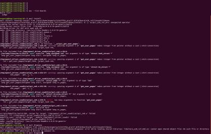

An a10gx board previously used on a Windows machine with a 16.1_pro package w/o any problems (installed, initialized (flash was programmed with 'acl0 boardtest.aocx', loaded and ran 'hello-world' and 'vector_addition') is now intended for use on a Linux machine with the 17.0 package, The variables on this Linux system are pretty standard:

The system is able to see the board with the 'aoc --list-boards' command. However, the installation with 'aocl install' fails. Please, see attached screenshot.
'aocl-diagnose' also fails.

The screenshot is too small to see anything in it but it seems you are getting some errors during the compilation of the kernel driver; my guess is that you are using an unsupported Linux or Linux kernel. Even though v17.0 now officially supports Ubuntu, I recommend sticking with CentOS v6.x or v7.x. The PCI-E driver will fail to compile on any other Linux.

Thank you. Interesting... The 'hello_world' example compiles into the .aocx file with 17.0 and this particular version of Ubuntu. I checked out of curiosity.
Altera_Forum
3,953 Views
The compiler itself will probably work with any Linux distribution and any Linux kernel; the problem is the PCI-E driver which will only compile on supported OSes/OS kernels.
