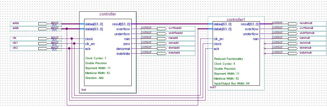

hi,
im trying to implement altfp_add_sub megafunction and altfp_mult megafuntion in a block design file. In the begining they look fine but when i finished the compilation part,i found only the adder inputs and outputs in the node finder tool. i couldnt found the mult I/O parts in the node finder. And also when i finished the functional simulation netlist generation,i found this Warning: Using design file controller.v, which is not specified as a design file for the current project, but contains definitions for 15 design units and 15 entities in project. https://www.alteraforum.com/forum/attachment.php?attachmentid=414 (the block design file) is there any possibility to implement two megafunctions by serial? thank youLink Copied
It's surely possible to use two series connected Megafunctions in a bdf design. But I wonder, how you can use single bit input ports adda and addb for the input busses and a non-bus connector line for a bus signal?
i dont know how to promote the input and the outpus pins on the megafunction. i think i just compile only the megafunction of add_sub.:confused: how i will do it? i want to promote these two megafunctions in one block design file. or any? thank you for your interest
Just connect the in- and outputs. But you need bit vector ports with busses (e. g. adda[63..0]) and thick line bus connectors.
