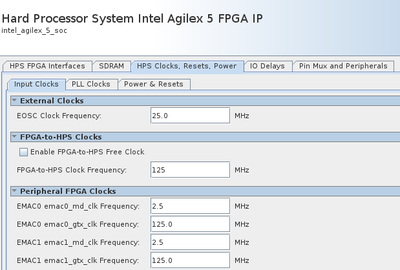

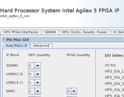

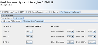

I am trying to ping one EMAC from another, and have instantiated the following in the HPS:
These are exported to the top level, then connected as followed:

In the .dts, I have the following config (based on the dtsi provided by altera
&gmac0 {
	status = "okay";
	phy-mode = "gmii";
	fixed-link {
		speed = <1000>;
		full-duplex;
&gmac1 {
	status = "okay";
	phy-mode = "gmii";
	fixed-link {
		speed = <1000>;
		full-duplex;
 However, when booting into linux - the drivers appear to be unhappy:
[   26.367856] socfpga-dwmac 10810000.ethernet: Failed to reset the dma
[   26.374250] socfpga-dwmac 10810000.ethernet eth0: stmmac_hw_setup: DMA engine initialization failed
[   26.383425] socfpga-dwmac 10810000.ethernet eth0: __stmmac_open: Hw setup failed
[   26.588347] socfpga-dwmac 10820000.ethernet: Failed to reset the dma
[   26.594740] socfpga-dwmac 10820000.ethernet eth1: stmmac_hw_setup: DMA engine initialization failed
[   26.603759] socfpga-dwmac 10820000.ethernet eth1: __stmmac_open: Hw setup failed
Anyone maybe know what is the issue?

On top of what my other colleagues asked,  Can you also dump, the boot Linux log for all the lines that mentions "socfpga-dwmac"?
I want to understand if the Hard IP is even accessible or enabled correctly by the Quartus design for Ethernet. The example i have here is for gmac2. But you are using gmac0 and gmac1. It seems you are unable to even perform the initial setup of the ETH HW which has a DMA engine. This requires write to the ETH HW CSR register address.
I want to see if the GMAC0 and GMAC1 are even enabled correctly from the Quartus design at the HPS.
In the Quartus HPS config, did you enable GMAC0 and GMAC1 from the dropdowns to select the function?
GMAC0: → [ RGMII ] / [ SGMII ] / [ Disabled ]
GMAC1: → [ RGMII ] / [ SGMII ] / [ Disabled ]
This should be propagated as a handoff data to the U-boot HPS FSBL which will configure the PINMUX and also CLK settings. The Handoff is important to the HPS to configure the ETH clock settings and pinmux. The GMAC0 and GMAC1 reset should already been de-asserted by the U-boot during boot-up. So, i don't suspect the reset de-assertion. It is either the CLK or the PINMUX or a combination of both. Without CLK, the IP will be permanently be disabled. CLK is the major suspect.

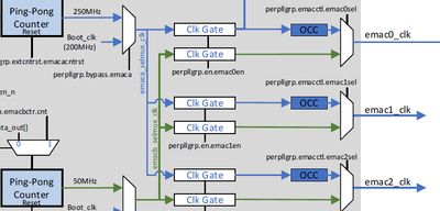

In short, I suspect that, the GMAC0 and GMAC1 CLK are disabled by a bad Quartus configuration.
Log for Linux: Example for a working GMAC on GMAC2. I need to see the similar log for GMAC0 and GMAC1 on your end. I want to know how far it went before it threw the error.

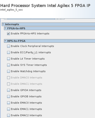

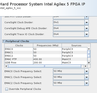

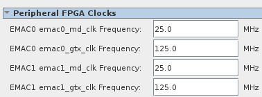

Additionally, here is the EMAC config:
I had assumed that since I am t using a PHY right now, I don't need to configure the PHY options - but perhaps the PHY needs to be set in either case?

TiensungA_Altera
8,142 Views

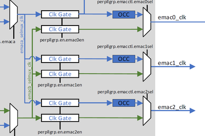

I would be questioning why emac1 and emac0 clk are disabled for some unknown reason. From the CLK dump from Linux, I believed the Quartus design may have an issue.
These 2 clock gates the GMAC0 and GMAC1 (emac0_en , emac1_en). That is why GMAC2 is the only one working.  We don't know why yet.
Thanks for all the dumps.

In terms of the clocking setup - I am currently doing the following:
- Feeding the output 1/2.5G port of MAC-0 to the input 1/2.5G port of MAC-1
- Feeding a custom 25MHz clock generated in the Fabric to the 10/100M ports of each MAC
I notice that in the HPS editor, there are these fields:
Which is confusing, as it makes me wonder why there is the extra option here (also documented here as not used in 1/2.5G
input  wire        emac0_mac_tx_clk_i_wire,     // not used in 1/2.5 Gbps
When exporting the EMAC interface from Qsys to the top level design.
However - it is not clear from this error report how the signal should in fact be connected to avoid such an error.

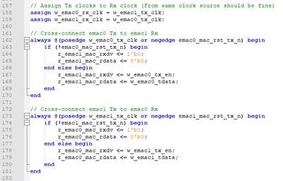

For a MAC-to-MAC loopback test, it requires additional logic. The main logic that enables this is:
fyi, this code above has not gone thru validation, but my colleague has tested the basic functionalities (ping and iperf transfers).
