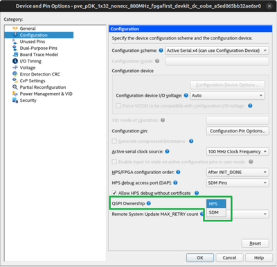

RolandoS_Altera
1,960 Views
Hi Eric
In 25.1 a new feature was introduced to control if you want to allow or prevent to grant the ownership of the QSPI to the HPS.
https://cdrdv2-public.intel.com/853092/ug-813762-853092.pdf
See section 4.2.1 and 4.12.
Check in your hardware design if the QSPI ownership is assigned to the HPS. If this is not the case, then the SDM will reject the MBOX_QSPI_DIRECT mailbox.
Rolando

EricOpitz
1,757 Views
Hi Rolando,
This solves the problem. Thank you for your Help!
