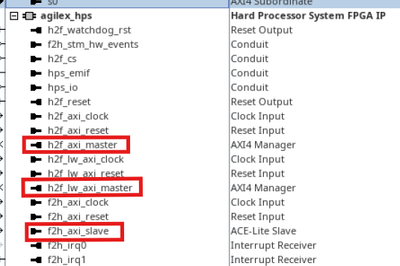

These are the details, about how the software driver gets the address 0xF9001080 for the LED.
After following the steps here:
https://altera-fpga.github.io/rel-25.1/embedded-designs/agilex-7/m-series/hbm2e/ug-gsrd-agx7m-hbm2e/#build-hardware-design
You can find ghrd_agfb027r24c2e2v.qpf and qsys_top.qsys in the agilex_soc_devkit_ghrd.
These can be used to open the project in Platform Designer.
By default, GHRD enables all HPS bridges.
You can find more information for the HPS Parameters for bridges here:
https://www.intel.com/content/www/us/en/docs/programmable/683581/current/hps-fpga-axi-bridges.html
You also can check where the bridges connected to via the Agilex HPS IP.
Tracing down to h2f_lw_axi_master, the address offset for the pipeline bridge is 0x1000.
Through the pipeline bridge, the PIO IP (led_pio) that controls LEDs has address offset of  0x80.
0xF9000000 + 0x1000 + 0x80 = 0xF9001080
