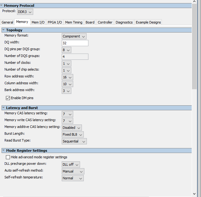

The above is the ddr config we kept
Previously our CAS latency for read for our DDR3(MT41J128M16JT-125) in our board connected to ARRIA10 SOC (10as016e4f27e3sg) is 11 and we tried to change it to 7 and then that bin file onwards our soc stopped booting and the log is attached.
The thing we want to confirm is will there be any effect of this on the ddr read and which affects the arm boot.

Hi Sir, Incorrect CAS latency setting might cause the DDR calibration fail. However, from the log file, I don't see any failure include the booting also seem successful.
