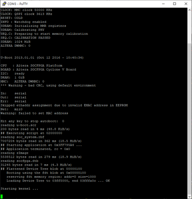

I'm trying to use lubuntu OS at DE1-SoC board, through HPS.
I was well using the device for a few months, but recently I cannot boot the device properly.
The error log from the serial terminal is as follows:
It seems that the above log doesn't contain enough information.

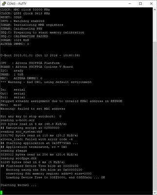

Hello Aik, thank you for your prompt reply.
I've replaced soc_system.rbf file with the default GSRD file with the latest version but still got the same message.
(In addition, altera_load function fails!)
I'll try to make a new booting disk using the past releases (u-boot-cyclone5.img) and let you know about the results.

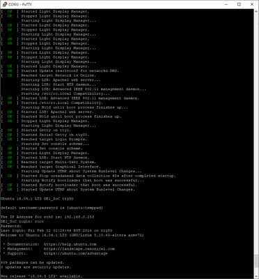

After replacing zImage file rather than .rbf file, I could successfully boot the device
(It might be obvious since .rbf file only contains the FPGA programming data and zImage contains Linux kernel data...)
Thank you for your suggestion!
