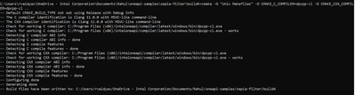

Clang/clang++ cannot be used to compile source files containing dpct headers (even if you try to provide dpct headers with -I). DPC++ compiler driver is required to compile dpct codes.
To correctly generate Unix makefiles using CMake on Windows, follow these steps:
  1. Open "Intel oneAPI command prompt for Microsoft Visual Studio 2019". This step will place DPC++ and other compilers in path. (by sourcing the setvars.bat file)
  2. Make sure that you have the directory containing make.exe in your environment PATH.
  3. Change current directory to your application directory containing CMakeLists.txt.
  4. mkdir build && cd build
  5. cmake -G "Unix Makefiles" -D CMAKE_C_COMPILER=dpcpp-cl -D CMAKE_CXX_COMPILER=dpcpp-cl ..
You should be able to see the output as follows:
To generate VS-2019 project files/Solution files (.VCXproj/.sln) using Cmake, the command would be:
cmake -T"Intel(R) oneAPI DPC++ Compiler" ..
Let me know if you face any issues.

Could you attach your CMakeLists.txt file if possible?
I have tried to generate Unix Makefiles on sepia-filter official sample with CMake version 3.17. It seems to work for me with the steps that I had given earlier.
Link: https://github.com/oneapi-src/oneAPI-samples/tree/master/DirectProgramming/DPC%2B%2B/CombinationalLogic/sepia-filter
Let me know if you are able to generate Unix Makefiles for this application with the steps that I had provided earlier.
Rahul

RahulV_intel
19,081 Views
I don't see any issue with your CMakelists file.
Could you also try building the Github sample which I had sent earlier on Windows and see if that works?
Alternatively, you may try upgrading your CMake to the latest version and see if it helps.
