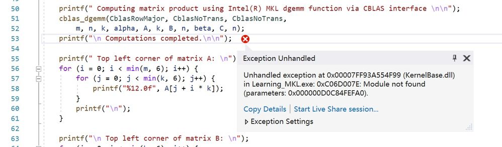

I am an newbie using intel MKL. Recently, I developed my source code in the VS2019 IDE environment. First, I started with the sequential mode, and the compilation is correct, and the final executable file can be executed correctly.
Then I tried the parallel mode by using OpenMP threading library. Environments setting are below:
1. VC++ Directories/Include Directories: <Root>\oneAPI\mkl\2021.3.0\include
2. VC++ Directories/Library Directories: <Root>\oneAPI\mkl\2021.3.0\lib\intel64 and <Root>\oneAPI\compiler\2021.3.0\windows\compiler\lib\intel64_win
3. Linker/Input: mkl_intel_lp64.lib, mkl_intel_thread.lib, mkl_core.lib, libiomp5md.lib
4. C/C++/Code Generation/Runtime Library: Multi-Threaded Debug DLL
With such settings above, the compilation and building are correct, but when i started debugging, it hits an error. The code i used is one of code examples from Intel official website.
with this error, I found the reason is missing the libiomp5md.dll. so I copy this file from "<Root>\oneAPI\compiler\2021.3.0\windows\redist\intel64_win\compiler" to the directory where the executable file is. then, I can execute this code without error.
It seems that the "<Root>\oneAPI\compiler\2021.3.0\windows\compiler\lib\intel64_win" in the Library Directories is not functioning.
Does anyone know how to correct this error in the VS2019, because copying the libiomp5md.dll to directory where the executable file is not an elegant way.
