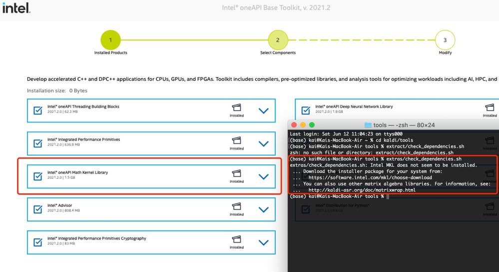

Hi, I'm wondering how to apply the MKL into the system environment. Cuz I have already download and install the oneAPI,  but when I make the use of it, the terminal still said that the
Intel MKL does not seem to be installed. 5561623663543_.pic.jpg5571623663599_.pic_hd.jpg

The environment needs to be sourced using the setvars.sh, to make it compatible for MKL to work fine.
You can follow the below link to achieve it.
https://software.intel.com/content/www/us/en/develop/documentation/oneapi-programming-guide/top/oneapi-development-environment-setup/use-the-setvars-script-with-linux-or-macos.html
Let us know, if issue persists.

Thank you for your reply! I have already used setvars.sh , while I want to set up in my default environment, but I can't find the /etc/environment file. Is there any detail for the environment setting for MacOS?

So, do you want to run your MKL executables on default environment, without sourcing the environment every time with setvars.sh ?

Yes, I want to set MKL as the default environment on my Macbook, so do you have any approach to guidance?

You can include the oneAPI environment sourcing script in bashrc file. By doing this, every time your default environment gets sourced and you can use oneAPI MKL without running the script every time.

I know how to solve it, many thanks!!
