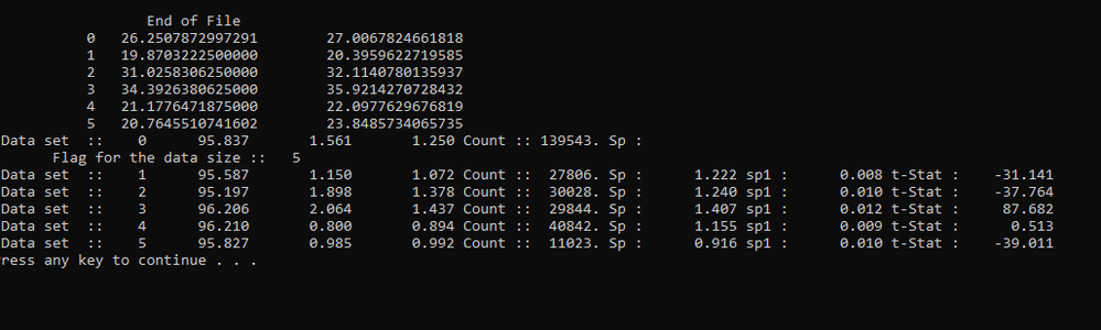

A quick and dirty attempt at the Student's t Test for million element sets, where I pick out the first peak between indices of the count array from 89 to 101 provides a set test data to determine if the natural frequency changes with time.  It appears to - each million elements is 100 days and each million elements contains about 4% density in the required range.
  subroutine mean(i,j,countFZ, meanA, stdevA,countFZA,meanFZA, standevFZA, flag)

    end subroutine
I took the standard algorithm from wikipedia -- not equal means or variances.
A t-Stat of 31 to 80 represents an almost zero chance they are the same - mean is 95 column and the variance is the 1.15 column.  The counts make is so accurate.
Got to check it and put in error checking.
There is a temperature dependence on the stiffness, but it is impossible to discern at 100 day blocks with any accuracy.

The data is in a format where is is simpler to take the first moment and then the second moment to get the variance.
The interesting issue is the amplitude of the t-Stat -- it is way beyond the published tables. So I will need to encode estimating the probability as well.  A 1:1000 p value has a t-Stat of about 3.5 for this number of elements, but we are at 37.  Interestingly the same problem arises in EXCEL with large data sets when you start looking for 5 and 6 standard deviations p estimates.
integer countFZ(kl)
REAL (KIND=dp) counter, count, counterV, countold,t, sp,sp1
counter = counter + real(countFZ(k)) * real(k)
meanA = real(counter)/real(count)
counterV = counterV + (real(countFZ(k))) * ((real(k) - meanA) ** 2.0)
count = count + real(countFZ(k))
counter = counter + real(countFZA(k,l)) * real(k)
count = count + real(countFZA(k,l))
counterV = counterV + (real(countFZA(k,l))) * ((real(k) - meanFZA(l)) ** 2.0)
The code is using real(dp) for variable types of the results (lhs) contained within loops where k iterates a million (millions?) of times.
the use of real(something) as opposed to real(something, kind=dp) may introduce undesirable round off errors.
