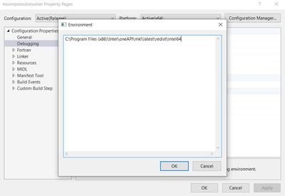

until today, I had visual studio 2019 installed with Intel Parallel studio and all was fine. I decided to install the new Intel onAPI. I uninstalled Intel Parallel Studio at first, then downloaded the one API base and HPC toolkit. I installed the base first then installed the HPC. I am doing that for using it for FORTRAN
I tried running my old projects that use use MKL as parallel or even sequential. I cant run any project that use MKL, I am sure the libraries are there in the directly and the visual studio rebuild the project without error but when I try to run the project, it tells me
" The code execution cannot proceed because mkl_intel_thread.1.dll was not found. reinstalling the program may fix this problem " . I uninstalled the hpc kit then uninstall the base one api then reinstall them again but it didnt work.

Hi Yusuf,
Follow these steps to include the missing DLL path:
  • Open the project property pages (Alt + Enter)
  • Change the Configuration to Debug (On the top left corner)
  • On the left window, under the Configuration properties tab, click on Debugging.
  • Under the Action tab, click on the Environment field and add the following:
PATH=C:\Program Files (x86)\Intel\oneAPI\mkl\latest\redist\intel64;%PATH%
Save the changes and run your executable. Let us know if you face any issues.

YusufThaer
11,546 Views
I tried it and it worked.
When I opened oneAPI command and write DEVENV, the visual studio starts and things work like charm.
but I couldnt add the path as I dont know how to add it

YusufThaer
11,500 Views
I found the place where the missing dll exists. I copied the path from the explorer and added it in the environment in debugger but it didnt work.
RahulV_intel
11,449 Views
Hi Yusuf,
Rahul
