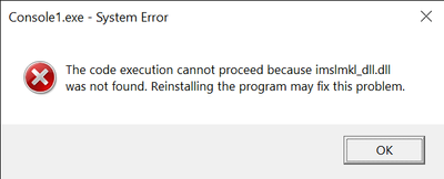

I have some problems running Fortran under Visual Studio 2019. The versions of products I have are Intel Parallel Studio XE 2020, Fortran Numerical Library for Windows/Intel Parallel Studio XE (x64), and Intel one API Base & HPC 2022.
The solutions can be built with no error except that a window pops up saying that "The code execution cannot proceed because mkl_intel_thread.1.dll was not found. Reinstalling the program may fix this problem." In particular, it occurs when I call a function.
My issue looks similar to the one here https://community.intel.com/t5/Intel-oneAPI-Math-Kernel-Library/mkl-intel-thread-1-dll-was-not-found/td-p/1287801 I tried to add a path under Environment Variable but it did not work. Could anyone please elaborate on what I should do? Thank you.

Thank you for your reply! I have attached the project that has this issue.
I have compared my settings with those in the sample project found in your link. In fact, this problem can be fixed when I change the line "INCLUDE 'LINK_FNL_SHARED.h'" to "INCLUDE 'LINK_FNL_SHARED_IMSL.h'", though I am not sure about the mechanism.
Apart from that, using the same settings, when I run the two validating programs provided by imsl (https://help.imsl.com/fortran/current/common/README.html), I receive the error messages (please see the attached). Are they also related to my previous issue?

Could you please let us know if you are calling routines from Intel oneMKL library in your code and not from IMSL?
I tried running the code and below is the error message that I'm getting that is different from yours.
Vidya.

Thank you for your reply. I have attached a new project using the sample codes of CNR (https://www.intel.com/content/www/us/en/develop/documentation/onemkl-windows-developer-guide/top/obtaining-numerically-reproducible-results/code-examples.html) with a screenshot of the result. I think I am only using the OneAPI MKL library this time.
I need to use IMSL at some point. But would you please let me know if the attached figure means that I have misspecified anything for the OneAPI MKL?

In the reproducer code, Include 'mkl.fi' is commented out in line 2, therefore the attempt to call mkl_malloc triggers an access violation.
After including the mkl.fi file, we see errors because of multiple declarations of mkl_malloc and mkl_free, so comment out the corresponding lines (7-12). Besides that, the arguments of mkl_malloc cause another error. You may remove the %VAL calls. An example of calling mkl_malloc in Fortran can be found in $MKLROOT/examples/f/service/source/servicefuncs.f.
Please find the attached project file with the above changes, try running it, and do let us know if you face any issues.

Thank you for your time and all the explanations! I can get those errors when I comment on different parts of the codes.
In fact, I am able to run my own Fortran codes with these libraries. Setting up the properties can be very tricky but I have not encountered many serious issues so far.
