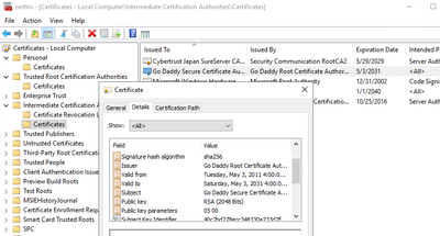

Please provide the details of the certificate (the SHA level of all the certificates in the certification path provided for GoDaddy, the enhanced key usage in the provision cert). You can share an image of the certificate root from Windows.

This is a PoC environment. I am deploying only one DELL OptiPlex 7000 with vPro Enterprise.
Let me attach the screen shot of certificates. If I am missing something, please let me know.

According to the images that you sent the GoDaddy Class 2 Certification Authority certificate is not SHA256; therefore, you will need to contact GoDaddy’s support directly and ask them to help you by providing a SHA256 version of it, once you have it you will need to completely remove the SHA1 version of that certificate from the system and then import the new version making sure that it is imported correctly.

I have confirmed that when I install my personal certificate or intermediate certificate issued by GoDaddy, the root certificate with SHA1 is installed automatically. I do not have to get the root certificate from https://certs.godaddy.com/repository as described in the manual “How to Purchase and Install GoDaddy Certificates for Intel AMT Remote Setup and Configuration”. It happens automatically.
As for SHA1 issue, the GoDaddy support asks me to install “GoDaddy Certificate Chain – G2 > GoDaddy Class 2 Certification Authority Root Certificate – G2” (SHA256) instead of GoDaddy Certificate Chain > GoDaddy Class 2 Certification Authority Root Certificate” (SHA1). But SHA1 version of root certificate is installed automatically as I mentioned above, so I cannot delete the SHA1 version.
Can anyone tell the document “https://www.intel.com/content/dam/support/us/en/documents/software/software-applications/how_to_purchase_and_install_godaddy_certificates_for_setup_and_configuration.pdf” I am referring is up to date and all correct?
naohiro
16,330 Views
Because I could not delete the “Go Daddy Class 2 Certification Authority (SHA1)”, I have disabled the one (screen shot is available). Now I am receiving the different log output. Disabling the certificate is not mentioned in the manual. Is this the necessary procedure?

You can try the following:
Make sure you do not have any old GoDaddy provision cert in your local store that is SHA1, in case you do export it and save it, then delete it from the cert management (local machine) then you should install the new cert to make sure that all the certs within the certification path are SHA256, if a SHA1 cert is still coming up this should be evaluated with the vendor
If possible please share AMT version of your target machine
Jose A.
naohiro
16,164 Views
Hello Jose
Thank you for your suggestion. I could not delete the GoDaddy cert with SHA1 (It appears automatically when I install my personal cert) last time, so I disabled the one. The cert chain has shrined from 4 to 3 like I posted a screenshot. But it still did not work. Then I set MEBx PKI DNS Suffix then it worked.
I reconfigured another environment with not deleting nor disabling GoDaddy cert with SHA1. On client side MEBx PKI DNS Suffix set. Then it worked. So, AMT auto deploy succeeds with both SHA1 on top of the (4 step) chain and with SHA256 on top of the (3 step) chain.
As for CIRA I was using DNS server running on EMA server. The clients OS was pointing this DNS manually, but AMT(MEBx) was not. I have added the new zone to another DNS which DHCP server is pointing to. Then it worked. Now CIRA is connected, and I have access to client’s BIOS screen remotely.
Intel® EMA Agent: Win64-Service v1.9.0
Intel® ME: v16.1.25.1932  Admin Control Mode
Thank you for your help.
