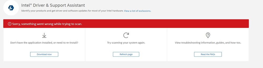

Cant update drivers with Intel® Driver & Support Assistant. What can be a problem?

Well, that is a good question. There is no "right" forum for the IDSA, but certainly Makers is incorrect.
One of the Intel support engineers may decide to move your post.
Regarding IDSA:
What operating system? Windows 10? What version? 1909?
What is your processor model number?
What is the model number of your laptop or system/motherboard?
You can try this:
From the control panel, remove ALL versions of IDSA that you can find.
Download and run this cleanup tool. https://downloadcenter.intel.com/download/29376/Intel-Driver-Support-Assistant-Uninstaller?v=t
Reboot
Then, try to reinstall IDSA from here: https://downloadcenter.intel.com/download/28425/Intel-Driver-Support-Assistant?product=128824

Okay. I tried delete and reinstall again. Didnt help 😥
Windows 10. 1909.
Asus x510uq. i3-7100U.

OK, one of the Intel support engineers will assist you. In the meantime:
Are you blocking any ports on your firewall?
What anti-virus are you using?
You can gather the logs, put them in a zip file, and attach them to this thread (using the paper clip).
The logs are located in C:\ProgramData\Intel\DSA
Look for
  • updateservice
  • servicehelper
  • tray
  • service
Put them in a zip file and attach it to this thread (using the paperclip). If you do not do a zip file, you will have to paste each one in a separate reply.

AndrewG_Intel
2,956 Views
Hello NOkay
We would like to jump in and help in case you still need assistance.
Based on the logs provided, it shows that you were running Intel® Driver & Support Assistant (Intel® DSA) version 20.1.5.6.
However, we have released a new version of Intel® DSA. The new version is 20.2.9.6 and it is available at the below link:
If you are still running the previous version 20.1.5.6 and having issues, we recommend the following steps:
1- Uninstall the previous version of Intel® DSA from Windows® Apps & Features.
2- Run the Intel® Driver & Support Assistant Uninstaller.
3- Clear Browser cache.
4- Reboot the system.
5- Install the new version of the Intel® Driver & Support Assistant Version: 20.2.9.6
If the issue persists after scanning with the new version, please kindly gather and provide a new zip file with all the files located at "C:\ProgramData\Intel\DSA" so we can investigate further. Also, please provide an Intel® System Support Utility (Intel® SSU) report and attach it to this thread. Please follow the steps below:
1- Download the Intel® SSU and save the application on your computer.
https://downloadcenter.intel.com/download/25293/Intel-System-Support-Utility-for-Windows-
2- Open the application and click "Scan" to see the system and device information. The Intel® SSU defaults to the "Summary View" on the output screen following the scan. Click the menu where it says "Summary" to change to "Detailed View".
3- To save your scan, click Next and click Save.
4- To attach a file, you must click the “Attach” option on the bottom left-hand corner of the response box.
Should you have additional inquiries, please do not hesitate to contact us back.

NOkay
2,956 Views
Yes, Im already answered in other thread. It's works, thank you.
