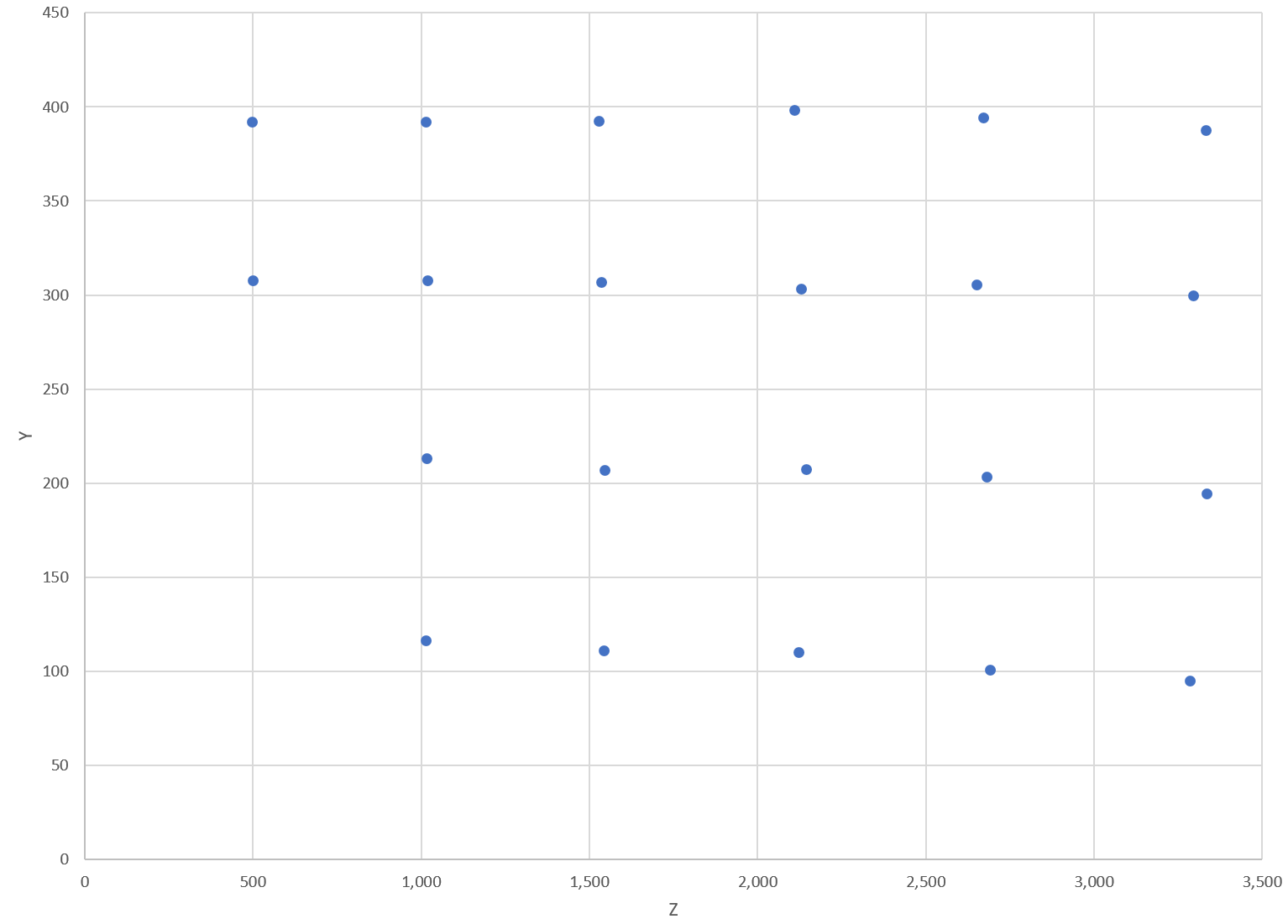

I am trying to calibrate my D435 by measuring the range to targets (Y=100mm, 200mm, 300mm and 390mm) at a known distances:
The camera is 390mm from the ground plane, horizontal (the top target is pixel row 240 at all distances), my spirit level tells me that my floor is flat and the targets are perpendicular.
I take the Z distance (the raw range from the camera depthmap, no post-processing) to each of the 4 targets, averaged over 100 measurements, for Z=500mm, 1m, 1.5m, 2m, 2.5m and 3m.
This is the Z-Y plot of the results (2'200 measurements):
The Y error is due due to the published +-3% tolerance in the vertical FOV (which I estimate by linear regression to be 56.1739°).
The true Z distance roughly follows the quadratic a*Z*Z+b*Z+c for a=-0.000039 b=0.0375 and c=-6.531 (which interestingly is the 7mm mentioned in this thread /thread/128141 https://communities.intel.com/thread/128141 and I have no problem applying that to get a more accurate result.
Now my setup may be a little off-kilter, but the Z error is consistently some +300mm (+10%) at 3 metres.
That the error increases as a square of the distance, I fully understand, but assuming that the error is gaussian it should average out over 100 measurements and not systematically increase as a function of Z.
Have I made another glaring blunder?

I've repeated the experiment, logging every measurement, with its timestamp, see attached .XLS.
The true distances 500, 1'000, 1'500 etc are measured from the camera's glass, with a steel ruler.
Here's a screenshot of my test harness whilst measuring at 1'500mm:
FYI, at the bottom, you can see the values for column 424 at 1'000mm; the floor is flat out to 1 metre and then the Y increases almost vertically as expected, indicating the wooden target.
The red cross indicates where the obstacle is, I.E. the first pixel where the next pixel is >30mm higher.
The measurements are the raw range values at row 240 column 424, the centre of the camera (the true camera centre is actually 239.5, 423.5 but half a pixel is insignificant).
The unexpectedly large error seems to increase exponentially:
Interestingly, the intercept of the red trend line is very close to zero, which implies that the Z focal point isn't far from the glass.
So, merging this question with my related focal-point question, /thread/128141http:// https://communities.intel.com/thread/128141
  1. From this data, where is the Z focal point?
  2. Why does the error increase with range?

It seems like I haven't been clear enough between https://en.wikipedia.org/wiki/Accuracy_and_precision accuracy and precision.
My camera is remarkably precise (RMS deviation from the mean), it's nearly as good as a D415, according to your graph:
It's the accuracy which is the problem, the error is over 425mm at 3 metres:
When measuring a target 3 metres away it reports an average range of 3425.39 over 100 readings with an RMS error of ~17mm.
Statistically, one would expect the measurements to be a gaussian distribution around 3000mm and not around 3425.29mm.
Those numbers equate to an RMS precision of ±17mm (which is stunning) but an inaccuracy of 425.39mm (which is ghastly).
Does that make my issue clearer?

My Z-Accuracy (section 1.3.1, page 7) is incorrect by 425mm at 3 metres, whilst your error graph says the Z-Accuracy error should be around 35mm.
The issue remains: Why is my camera's Z-Accuracy an order of magnitude worse than expected?
