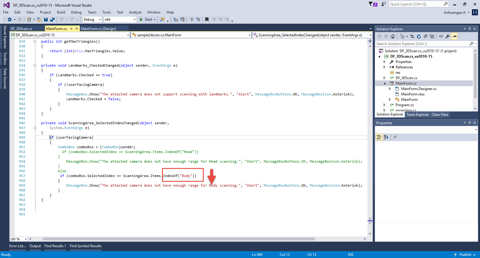

How I can change configure for area of camera?
I use SDK R2 to scan model, but height is limited.
MartyG
4,994 Views
If you are scanning a human body, try clicking on the arrow at the end of the Full option to drop the menu down, and select the 'Body' option.
AHoan1
4,994 Views
I know, but the option 'BODY' can not scanning.
Could you please try scan with option 'BODY' and take a capture for me.
I have tried so many times before and failed.
Please help me change configure of are.
MartyG
4,994 Views
Reading the 3DScan instructions, it looks like the Full option was the correct one for a full human body, as it provides the largest scanning area.
If the camera cannot see the whole body then you should move the camera further away from the body so the camera can see more of the body.

I use SR300, if depth over 50cm, it is out of range?
MartyG
4,994 Views
Sorry, I forgot you were using an SR300 and not a R200 with much longer range. The SR390 is not suited to scanning the full human body because of its limited range. The R200 is the best camera for full body scanning. Because of the SR300's range, it is better at just scanning the head.
The only way I can think of to get depth range on the SR300 like that of the R200 is to use IVCamFilterOption to give the SR300 longer range at the expense of scanning accuracy.
https://software.intel.com/sites/landingpage/realsense/camera-sdk/v2016r3/documentation/html/index.html?ivcamfilteroption_device_pxccapture.html Intel® RealSense™ SDK 2016 R3 Documentation
