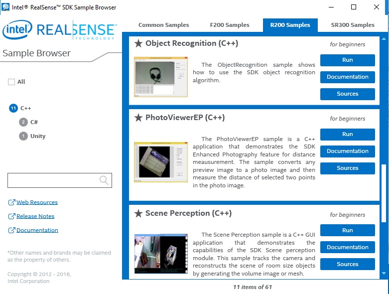

I understood the question. I was primarily quoting the YouTube video as an example of RealSense's depth perception capabilities, Yes, RealSense is capable of looking at an object and recognizing it.
In the Sample Browser application that is packaged with the SDK, you can use the menus on the top and side of the window to filter by camera type (R200) and the language that the sample is in (e.g C++). There is an Object Recognition sample there. It is also available in the C# language.

I have now done a clean installation with Realsense 2016 R2 SDK (Lates version for R200), but I can't find the Sample Browser. I had the browser installed when I ran 2016 R3 SDK, but with R2 I can't find that browser.
I read somewhere that R200 is not supported by 2016 R3 SDK that I think would explain why I couldn't find that Object Recognition sample in the first case, when I installed 2016 R3 Essentials SDK.
That Object Recognition sample is found under the R200 Samples tab. Does it work with SR300 too?

The Sample Browser is typically installed on the desktop, separate from the RSSDK folder, in a folder called 'Intel RealSense SDK Gold'. It can be quite easy to miss if you have a crowded desktop.
The samples can also be accessed directly from the RSSDK/bin/win32 (for 32-bit versions) or RSSDK/bin/x64 (for 64-bit versions for Windows 10). You should ideally copy the sample files to another directory first before using them, since the bin directory is read-only. You do not need to do this if accessing them through the Sample Browser application.
The SR300 does not seem to have an Object Recognition sample, just Object Tracking.
