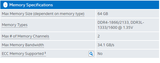

Well, the recommended the memory for your processor is;
If you are running DDR3 that could be the source of the issue. Is there any chance you can run your motherboard with the memory specification mentioned above?
Amy.
